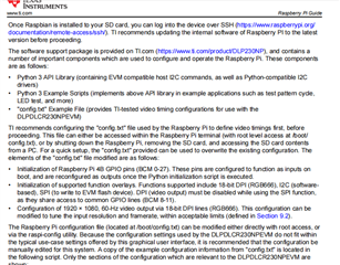

DLPDLCR230NPEVM能够正常工作。但我按照官网上用户手册中所说修改树莓派config文件并重启树莓派以后,树莓派一直彩屏且不能正常开机。不知道是我流程错误还是配置文件的问题?

dtparam=spi=on
# Configure Raspberry PI for SSH over USB
dtoverlay=dwc2
# Configure I2C on GPIO Pins #22 and #23
dtoverlay=i2c-gpio,i2c-gpio_sda=23,i2c_gpio_scl=22,i2c_gpio_delay_us=2
# Configure DPI on GPIO Pins #0 through #21
gpio=0=op
gpio=0=pn
gpio=1-27=ip
gpio=1-27=pn
# Enable DPI18 Overlay
enable_dpi_lcd=1
display_default_lcd=1
dpi_group=2
dpi_mode=87
# Configure DPI Video Timings
# RGB 666 CFG 1 (MODE 5)
dpi_output_format=458773
# 58 Hz Timings (Low-End Spec)
# Works at GPIO DRIVE 5-7
hdmi_timings=1920 0 20 10 10 1080 0 10 10 10 0 0 0 58 0 125000000 3
