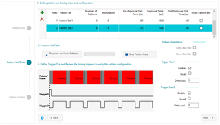

目前我有个应用场合是,光控制投影,由板子上MCU发送给DLP I2C信号,以完成一次所有Internal pattern投影,

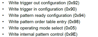

# 0x05 - Operating Mode Select
w 36 05 04
# 0x9E - Internal Pattern Control
w 36 9E 00 00
