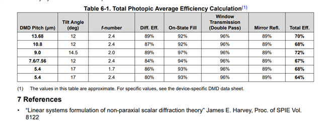

Overall optical efficiency of each DMD can generally be estimated as a product of window transmission (2 passes), diffraction efficiency, micromirror surface reflectivity, and array fill factor.
请问DMD的反射效率是多少? DMD反射的光通量/入射到DMD有效面积上的光通量
下文只写了 window transmission (2 passes),请问diffraction efficiency, micromirror surface reflectivity, and array fill factor.是多少?
