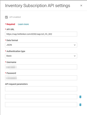

库存订阅接口报错
订阅库存接口报错
{"status":"failed","responseCode":0,"message":"I/O error on POST request for \"sap.hnthinker.com:8200/.../zcl_rfc_002\": PKIX path building failed: sun.security.provider.certpath.SunCertPathBuilderException: unable to find valid certification path to requested target; nested exception is javax.net.ssl.SSLHandshakeException: PKIX path building failed: sun.security.provider.certpath.SunCertPathBuilderException: unable to find valid certification path to requested target"}
  • 可以看一下你填写的Inventory Push 的设置么?证书可以发给我一下
  •  证书该怎么给你呢,文件上传不上去

  • Hi Yintang,
    能否检查您的callback服务器是否部署了包含所有必要的中间证书的完整证书链?
