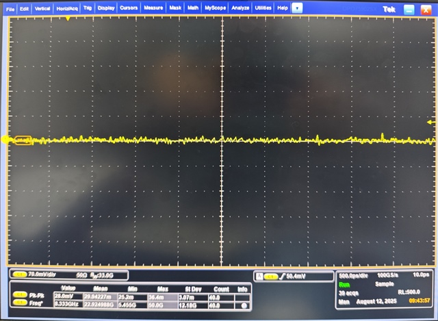

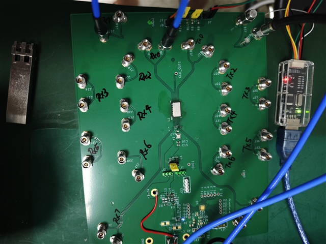

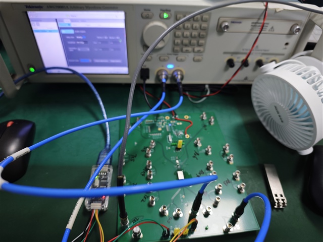

During the debug,I found if no data-rate is applied on the Rx-input channel of the DS280MB810, there is no output when the PRBS generator is enable.would you pls answer: how to turn on the prbs generator funciton when CDR is unlocked(no data-rate  on Rx-input channel).
Thanks.

  • 您好,非常感谢,不确定是设置的问题,还是如果使用PRBS的时候,就必须在输入端加个信号,让CDR处于锁定状态才可以。
    我上传一些这边调试的图片供参考。如果还需要什么资料请告诉我,我再补充。

     PCBA with DS280DF810
    TX1 ouput waveform at AWG PRBS on Rx1TX1 ouput waveform at AWG PRBS off Rx1.jpg
    1. The DS280MB810 does not have a PRBS generator.  I'm wondering if you're actually testing with DS280DF810.
    2. It is expected that the DS280DF810 requires CDR lock in order to use the PRBS generator.  This retimer implements a reference-less CDR architecture and uses the recovered clock from CDR for PRBS pattern generation.
    Please see this FAQ discussing this topic.
    e2e.ti.com/.../faq-ds280df810-why-is-25g-28g-retimer-prbs-generator-not-working
