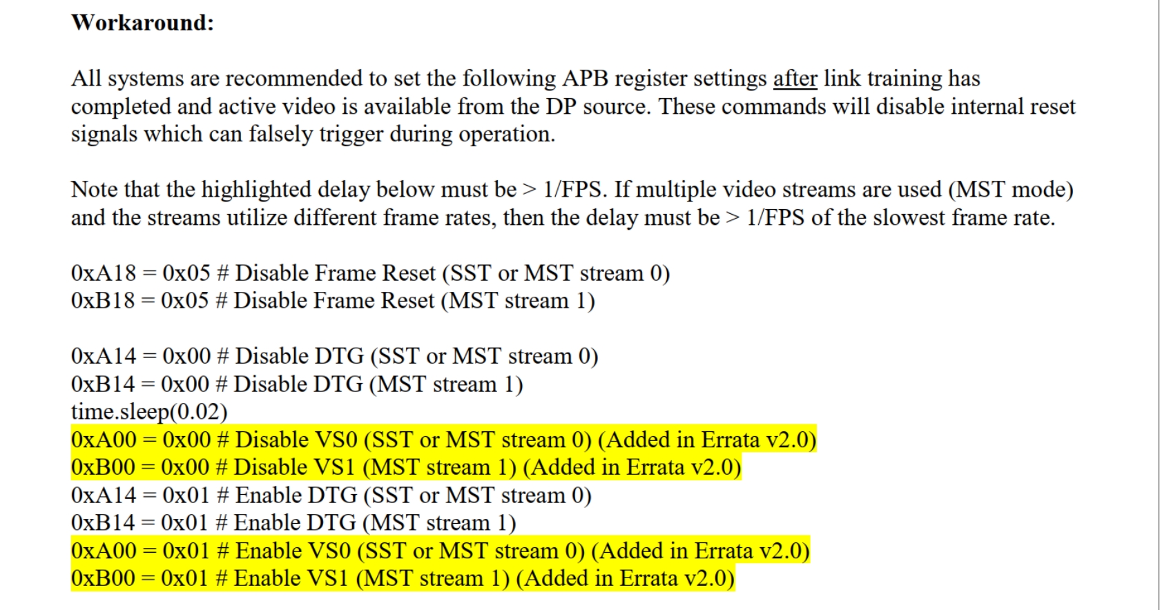

We are currently using the dual link mode. Could you please confirm whether 0xB18, 0xB14 and 0xB00 also need to be written

You must keep 0xB18, 0xB14, 0xB00 if you are also using VS1.
