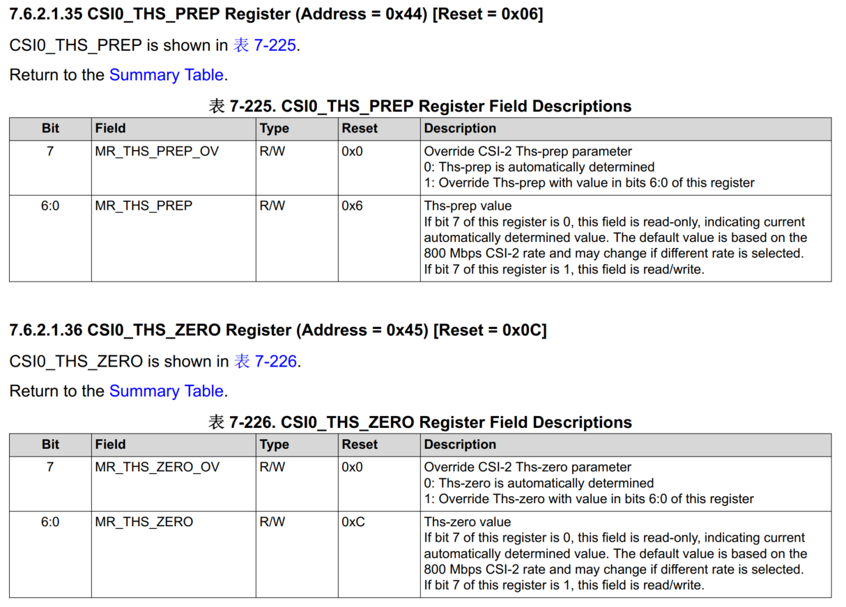

regarding my application, we have some requirement to FPD Link RX‘s CSI output timing, as below.
CSI_THS_PREP + CSI_THS_ZERO > 176ns
I find the following registers can be adjusted to tune output timing, but there is no more explanation about the register value how relate with the CSI timing. may you please
- the recommend registers value.
- the value relationship with CSI timing.
