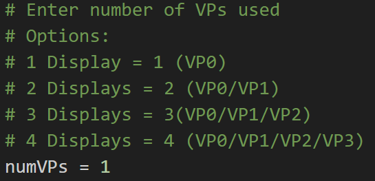

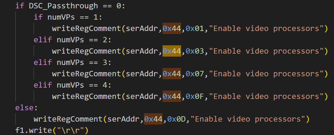

My customer AUO is using the DS90UB944A-Q1. They use INTB_IN as the interrupt pin and set the numVPs=1. When the MCU issues an interrupt instruction, the INTB_IN pin does not respond.
I have found  the corresponding code as below. Their basic configuration is also attached. Please help configure the code.
BRs,
Nora
image.pngimage.png983Conf-FPD3.txt

  • I don't see where in their scripts they're setting up interrupts ? What exactly do they need their INTB_IN to track ? Can you give me more details about this use-case.
    Currently they're just using normal FPD-Link Video configuration I don't see any interrupts register conifg.
  • Hi Eirwen,
    The current script of the customer does not include GPIO passthrough and INTB passthrough. So, could you please provide the customer with the code and a sample routine?
    BRs,
    Nora
  • serAddr = 0x18
    desAddr = 0x58
    board.WriteI2C(serAddr, 0x1B, 0x88)# Map SER GPIO1 to INTB_IN of DES
    board.WriteI2C(desAddr, 0xE, 0x1) #Port_SEL
    board.WriteI2C(desAddr, 0x44, 0x81)# Enable INTB_IN of DES
    This is assuming you already have I2C Passthrough enabled on the Ser and the Target/Alias addresses are set properly. If you want a global interrupt on the 984 whenever you pull the INTB_IN pin low, you can do an additional write to DES register 0x52 = 0x81.
