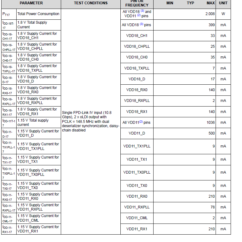

hi expert,
could you help provide the VDD11 and VDD18 current spec in signel FPDLINK IV input(6.75gbps), 2 OLDI outpiut, disable daisy chain. like below spec in datasheet:
