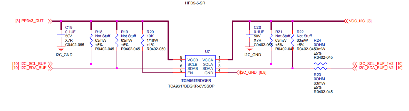

HI TI team:
In my application, TCA9617 is used as the I2C level converter(3.3V->1.8V), and the circuit diagram is as follows:
B side: Controller
A side: Target

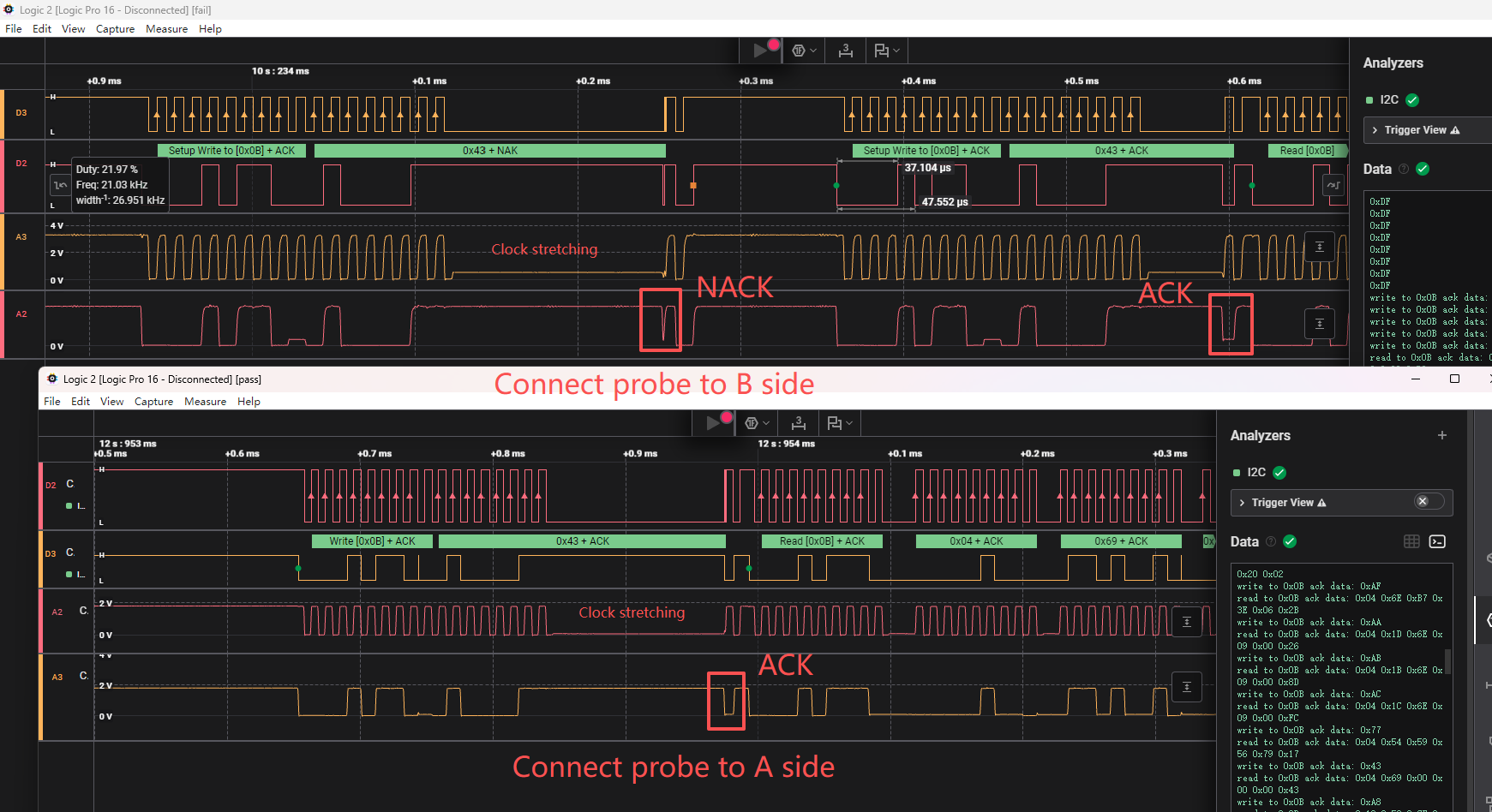

During debugging, it was found that I2C communication is unstable. Use a logic analyzer to capture the waveform as follows:
  1. When the probe is connected to the B side, NACK occurs in I2C communication, and the retry may return to normal.
  2. When the probe is connected to the A side, I2C communication becomes stable (even without retry).
Why does connecting logic analyzer/oscilloscope probes on I2C bus improve communication stability? How can I fix this issue?

    你是在I2C通信期间进行探测吗?
    每个探头都有特定的阻抗和电容。在通信过程中使用示波器探头相当于连接了一个未充电的电容器,这会将总线拉低。这可能是您在SDA上观察到尖峰出现的原因。
  • Yes, I captured the waveform during I2C communication。
    How can i fix it?
    Do we need to add equivalent resistance/capacitance on the SDA line?
  • 您好
    What I am suggesting is that the probes that you are using have some parasitic capacitance on them.
    When you connect them during I2C communication, there will be a slight dip in the signal because you are connecting an un-charged capacitor (the scope probe) to the data line SDA. Thus it pulls SDA LOW and causes a glitch.
    Does the communication work properly once the scope probes are attached? If so, your system is okay. It is the scope probe causing the data communication errors not your system.
