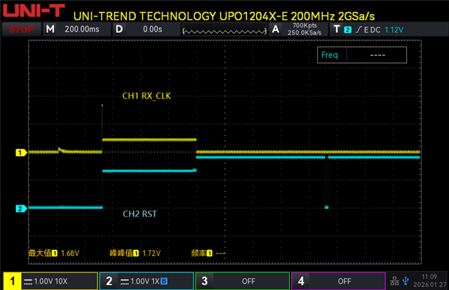

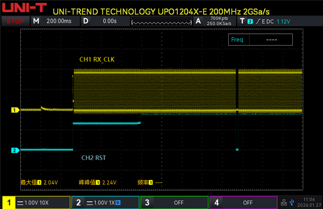

My test phenomenon are not same as above.In my test,only when the MDI link-up(there is an another master device in the BUS,our DP83TC812 work as a slave),RX_CLK will output automatically(show in figure1).
If there is no link-up,RX_CLK will not output 25M clk signal(show in figure2).
