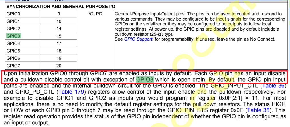

请问DS90UB960WRTDRQ1的GPIO3是Pull-push还是OD输出

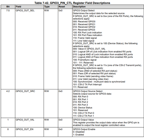

DS90UB960-Q1的GPIO3是一个可配置的通用输入/输出引脚。具体请参考数据手册87页Table 7-42. GPIO3_PIN_CTL Register Field Descriptions,
https://www.ti.com/lit/ds/symlink/ds90ub960-q1.pdf
