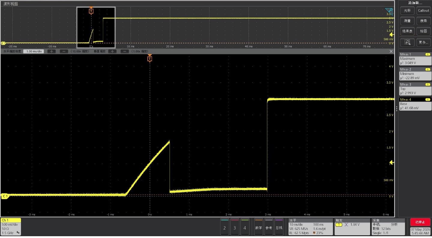

PCA9554: 上电过程IO口状态异常 Abnormal I/O pin state during power-up
Part Number: PCA9554
PCA9554在上电过程中,IO口的状态会先上升到一定电平,然后在掉下来,在重新稳定至高电平状态,表现异常,为什么会有先上后掉在稳定,不应该直接上升至VCC稳定状态吗
Upon power application, the I/O pins of the PCA9554 show an abnormal voltage waveform: the potential climbs to a specific value initially, then falls, and eventually stabilizes at logic high. Ideally, the voltage should rise steadily to VCC without this dip.

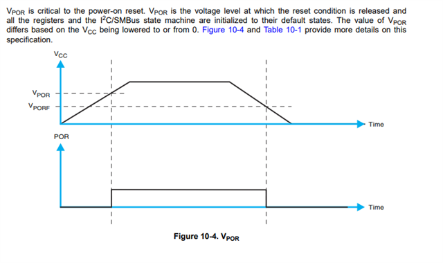

  • VCC开始上电时,100kΩ弱上拉使I/O引脚跟随VCC上升,此时芯片内部逻辑尚未完全初始化
    当VCC达到VPOR阈值(1.2~1.5V)时,内部上电复位(POR)电路触发
    配置寄存器复位,I/O配置为输入模式
    输出端口寄存器清零(默认值0xFF)
    在复位过程中,内部PMOS和NMOS晶体管(Q1和Q2)短暂进入不确定状态
    引脚阻抗可能暂时变化,导致电压下降
    复位完成后,I/O引脚重新配置为输入模式+弱上拉100kΩ上拉将引脚拉至VCC,达到稳定高电平
