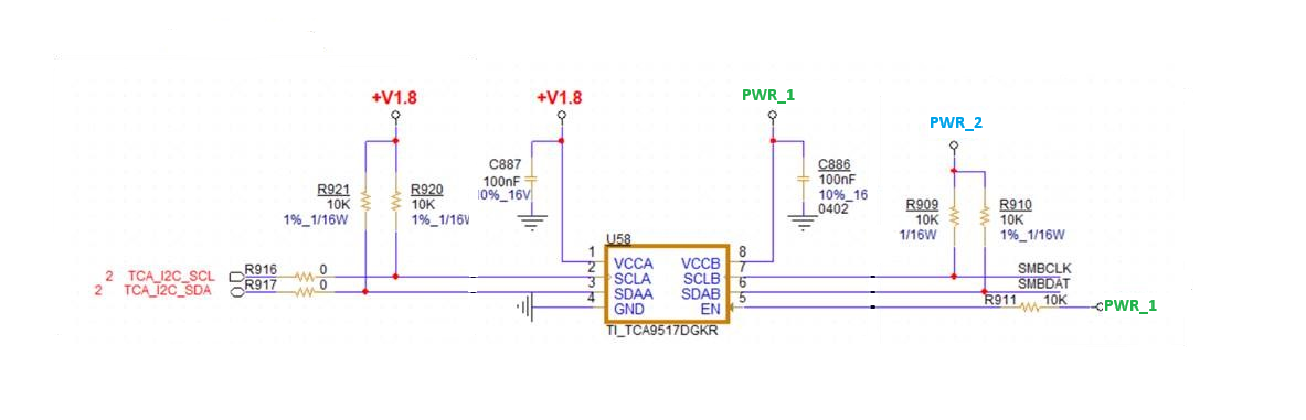

we want to use the TCA9517 and have a question regarding the voltage levels.
Is it allowed to use a different pull-up voltage for SCLB/SDAB than the supply voltage VCCB?
In our design:
  • VCCB (= PWR_1 in picture) is supplied separately
  • Pull-ups on SCLB/SDAB (= PWR_2 in picture) use a different voltage
  • We are planning to use two separate 3.3V rails with different power-up sequences. 3.3V pull-up Voltage ramps up before VCCB supply. The current for the pull upvoltage is only <40mA this is why we want to use a different supply
  • Additionally, we are considering using 5V for VCCB (PWR_1) as an alternative option
Our power-up sequence is:
Option 1: 1.8V (VCCA) => PWR_2 (pull-up voltage for SCLB/SDAB) => PWR_1 (VCCB)
Option 2: 1.8V (VCCA)  => PWR_1 (VCCB) => PWR_2 (pull-up voltage for SCLB/SDAB)
Is this configuration valid, or are there any concerns we might have overlooked?
Thank you for your support.
Best regards,
Benedikt

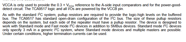

  • SCLB/SDAB is Connected to VCCB through a pull-up resistor in datasheet.
  • Hi Eirwen,
    Thank you for your reply. Sorry if I'm in the wrong forum but it was the only one i could choose when I created this thread.

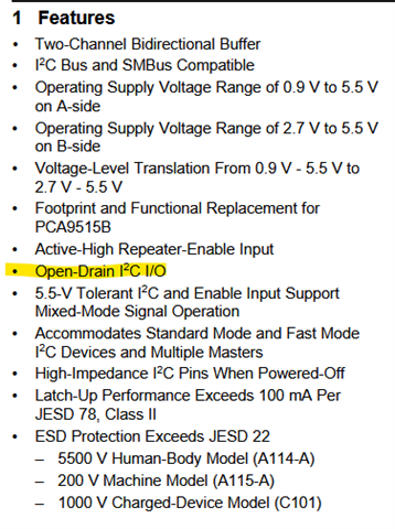

    We saw this in the datasheet. But the datasheet also mention:
    Page 1:
    Page 3:
    So we are not sure if the inputs are completely separated from the VCCB supply voltage. If they are separated it should possible to connect a different voltage source to VCCB. Or do I miss something?  Is there internally something that would connect SCLB/SDAB to VCCB. Because, in the case of VCCA, it is explicitly stated that the voltage is used only as a reference.
