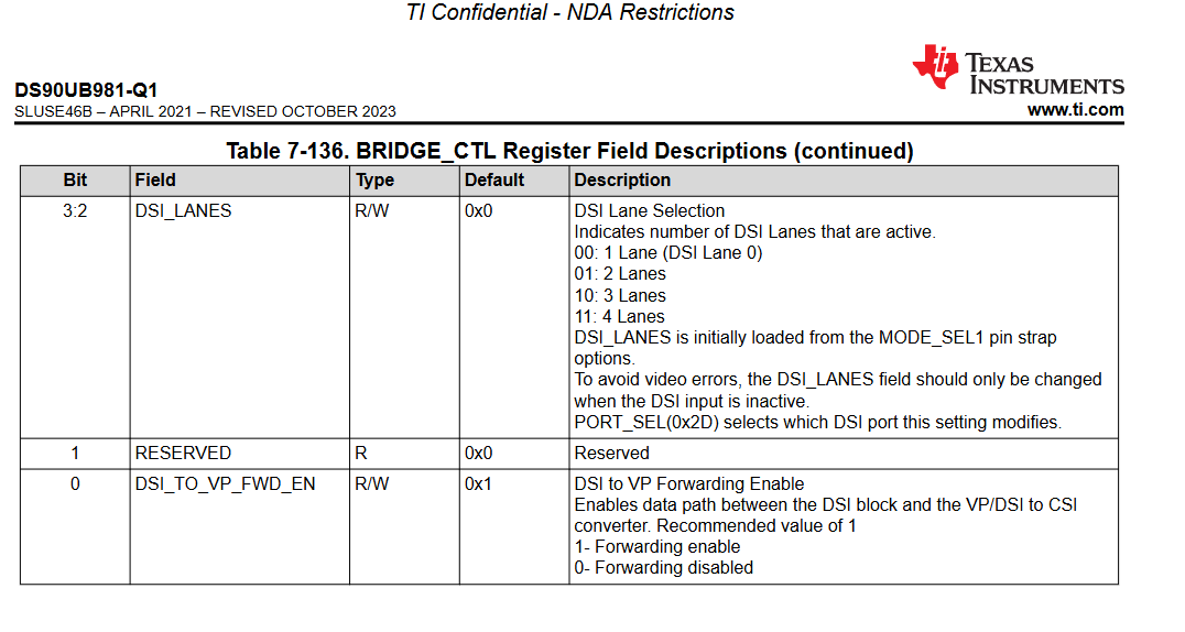

The DS90UB981-Q1 support dual-channel DSI (2clk+8lane) input ?
The datasheet only 4 lanes.
  1. If support dual-channel DSI (2clk+8lanes) input, how to set the registers?
  2. What are the recommended DSI (lanes number) settings when 3840x1080@30fps?
