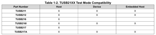

Is there any difference in the following parameters between TUSB216 and TUSB216I except for the difference in operating temperature? Please help confirm, thank you!
- Test Mode Compatibility
- Voltage range USB data
- ESD Ratings

Please check the following E2E post as the same question.
TUSB21xx High-Speed Signal Quality Test Modes
There was a PCN in 2024 that changed the die of the TUSB216 to the same die as the TUSB216I, so if the units were ordered in ~2025-2026, they should also support device mode testing.This is the reply from FAE to me, please confirm again. Is there a difference between the following two parameters of TUSB216/216I?
Review both devices' datasheet, the following performance are the same.
TUSB216USB 2.0 High-Speed Signal Conditioner With BC 1.2 Controller datasheet (Rev. D)
TUSB216IUSB 2.0 High-Speed Signal Conditioner With BC 1.2 Controller datasheet (Rev. A)
