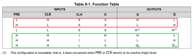

The application circuit of my SN74LVC1G74DCTR latch uses 100K pull-up to 3.3V for D and PRE#, and CLR# is pulled up to 3.3V with a 100nF capacitor to GND. 1. Why does Q sometimes show 0V or around 700mV after power-on? Changing the 100nF to 10nF improves it a bit, but it still happens. 2. Also, what is the output structure of Q and Q# for this device? It seems not to be push-pull.

        建议监测一下VCC与PRE,CLR的波形,您的问题与VCC脚在超过1.65V时,PRE CLR的电平不稳定相关。
    CLR的上拉电阻是多大的?也是100K?
    对于您目前的设计,由于PRE已直接上拉到3.3V,您尝试一下增大CLR脚电容(1uf 或10uf),使芯片在上电时满足PRE=H,CLR=L,
    然后再满足PRE=H,CLR=H的情况,根据CLK的上升沿输出。
    芯片的输出脚是push-pull.
