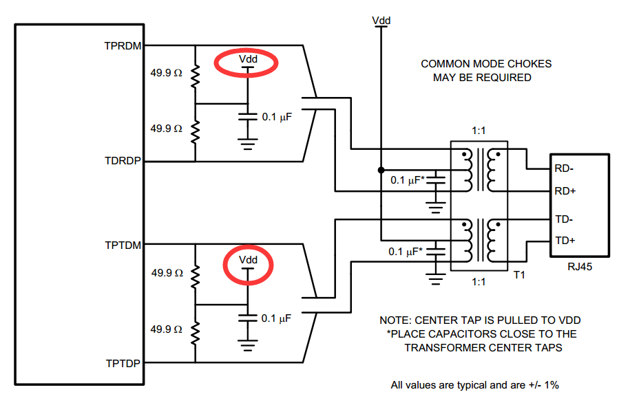

Hello,
When I use the ethernet PHY DP83848, I found that, I must connect the TX+/-, RX+/- of DP83848 to VDD by a 49.9 R resistor, Why?
