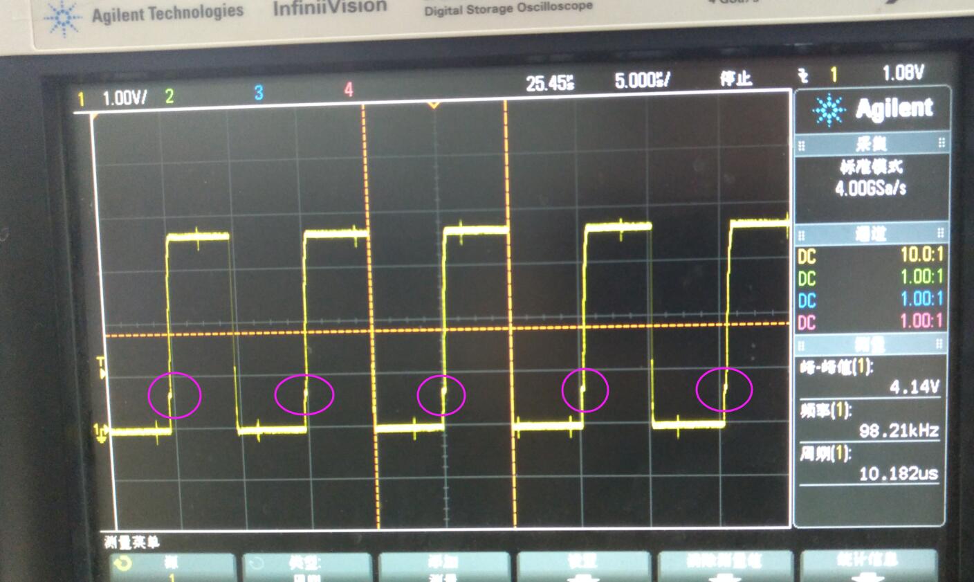

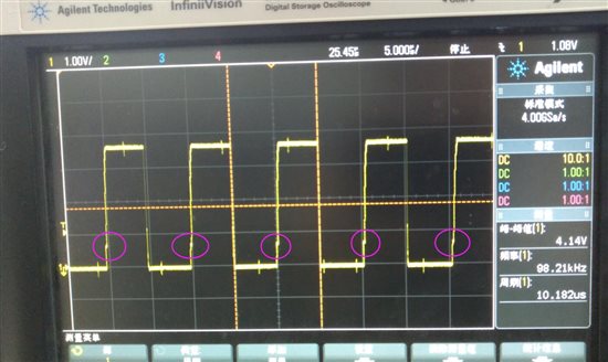

ISO1540改变I2C波形问题
Other Parts Discussed in Thread: ISO1540, ISO1541

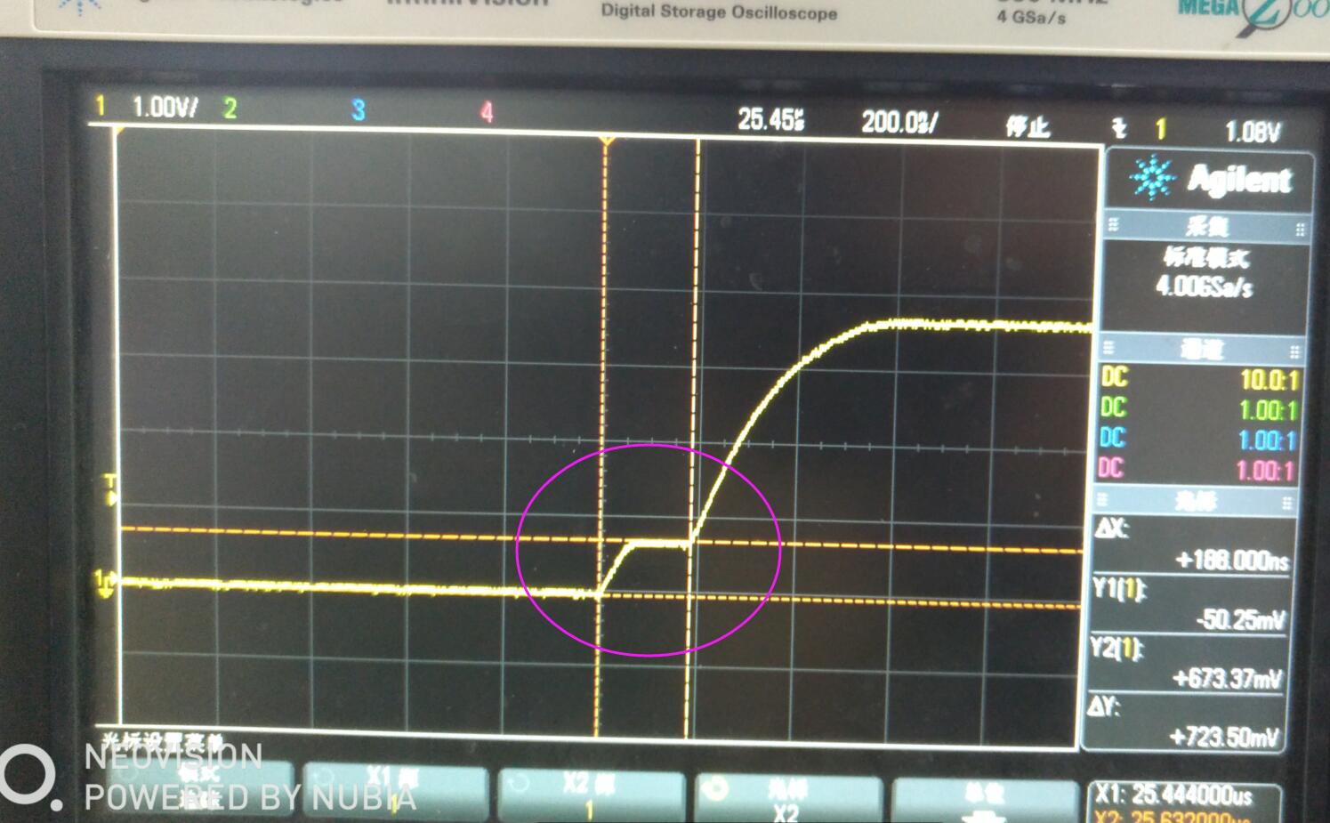

增加ISO1540芯片后,会改变I2C信号波形,请帮忙看看,是什么原因

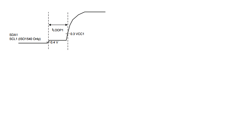

  • ISO1540是这样的,这点在datasheet中有描述: 大概在0.4V这里有个offset。Isolated bidirectional communication is accomplished within these devices by offsetting the low-level output voltage on side 1 to a value greater than the highlevel input voltage on side 1, thus preventing an internal logic latch that otherwise would occur with standard digital isolators.
    或者如果您不需要双向隔离的话,可以考虑ISO1541 ,这个和ISO1540的区别在于clock是单向的,只有data是双向的。
