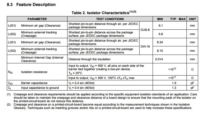

16pin的为DW封装,8pin的为DUB封装,主要区别有,
1)5000-VRMS Isolation (ISO1050DW)
2500-VRMS Isolation (ISO1050DUB)
2)TUV 5-KVRMS Reinforced Insulation Approval for EN/UL/CSA 60950-1 (ISO1050DW-Only)
3) CQC Reinforced Insulation per GB4843.1-2011 (ISO1050DW-Only)
其他电气性能上没什么区别。
