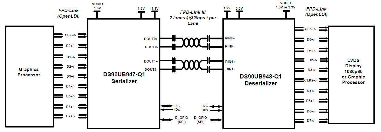

Imx6 can output lvds direct.But the lvds-wire is too  expensive to buy. So they can cannect ds90ub947 serializer to applied in automotive instrumentation. By the way, it need a ds90ub948 deserializer in the remote which cannect a lvds displayer.
The attachment is the driver of ds90ub947/948 for linux.It can  support linux 3.10 and above.It was verified working on linux 3.10.53 and imx6q.
