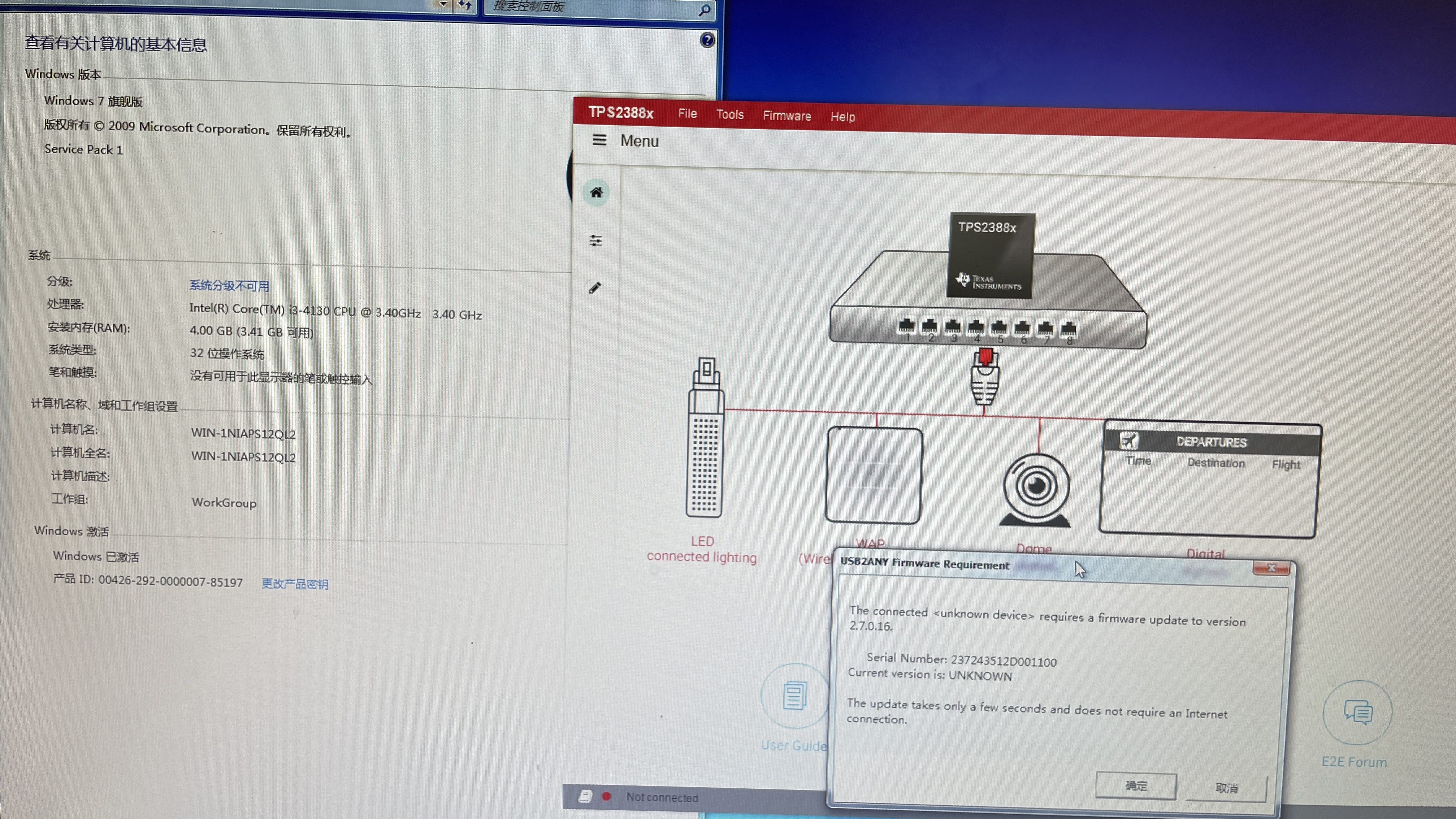

USB2ANY 固件升级失败
Other Parts Discussed in Thread: USB2ANY
您好
我在官网买了一个USB2ANY,连接电脑时,打开应用,提升附件图片中的错误,请问怎么解决?

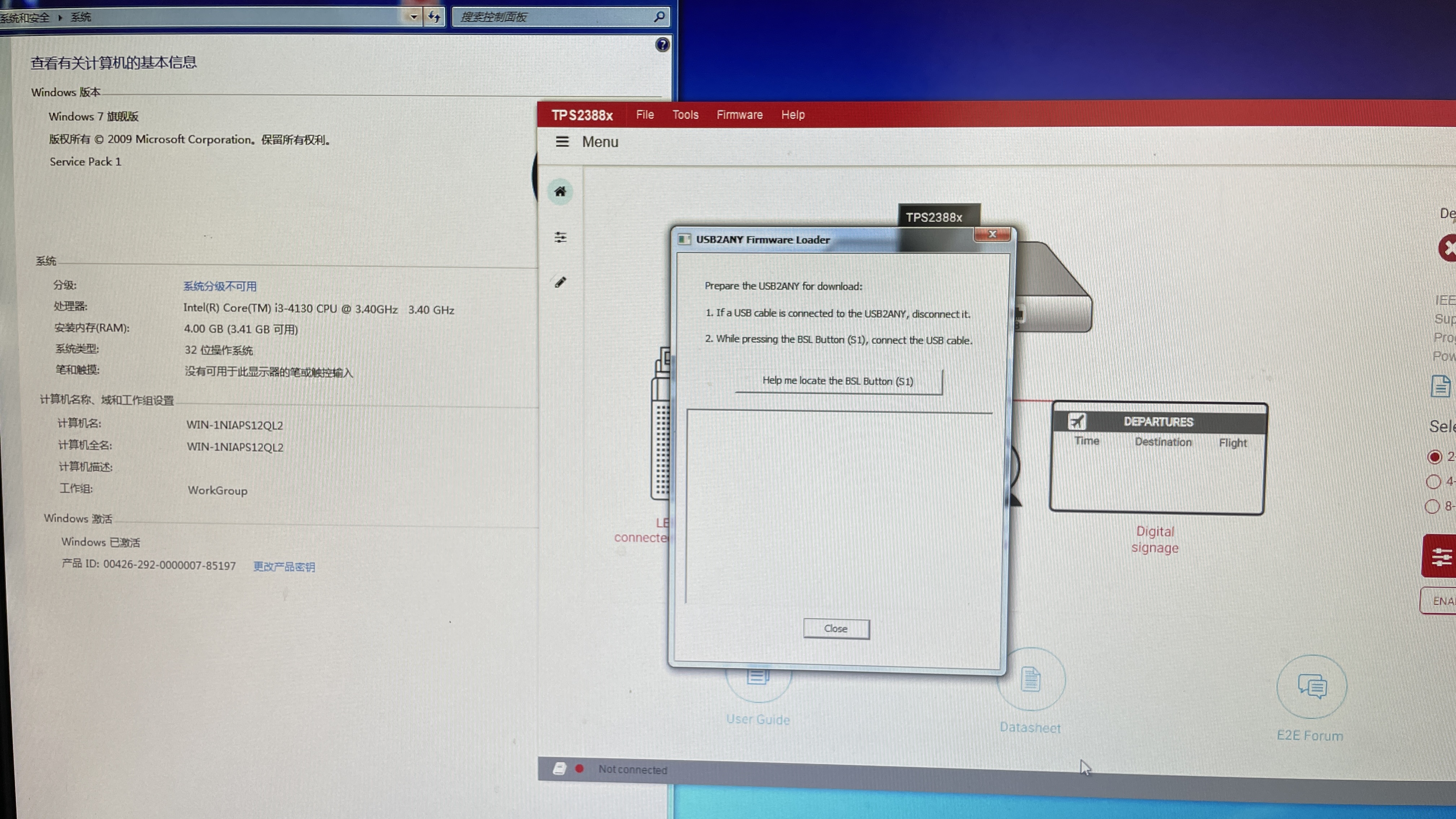

  • 您好,先按照上面的提示,建议1)先断开USB cable,然后点击 BSL button(S1),再连接USB cable.
    Switch S1 is used to put the firmware into bootstrap loader (BSL) mode. The BSL mode is used to load or update the USB2ANY firmware and is entered whenever the board is powered-up while Switch S1 is depressed.
    然后, 如果firmware 没有正确加载的话,按照下面帖子中给出的步骤 试试,是否能解决您的问题?
    e2e.ti.com/.../2688720
