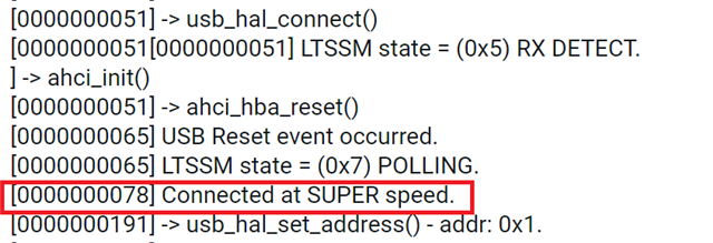

  • 我们在切换到USB3.0检测的时候,TUSB9261的debug  UART口输出的信息如下,请问这些log信息怎么解读?能大致跟我们说下吗?或者有什么文档描述可以参考吗?谢谢。

    [0000000051] -> usb_hal_connect()
    [0000000051[0000000051] LTSSM state = (0x5) RX DETECT.
    ] -> ahci_init()
    [0000000051] -> ahci_hba_reset()
    [0000000065] USB Reset event occurred.
    [0000000065] LTSSM state = (0x7) POLLING.
    [0000000078] Connected at SUPER speed.

    [0000002236] @Error: Timeout waiting for PHY Ready. P0SSTS = 0x00000000, P0SERR = 0x00000000.
    [0000002236] -> ums_uas_init_queue_depth() - 32.
    [0000002236] Connected to[0000002236] -> ums_uas_send_sense_iu() - cmd_index = 0, status = 0x02, tag = 0x1f, CDB[0] = 0x00, retry = N.
    0 AHCI device(s).
    [0000002239] -> ums_uas_send_sense_iu() - cmd_index = 11, status = 0x02, tag = 0x1f, CDB[0] = 0x00, retry = N.
  • 抱歉回复晚了,在您提供的debug信息中,其中已经有提示connected at super speed 说明USB3.0 link成功了.
