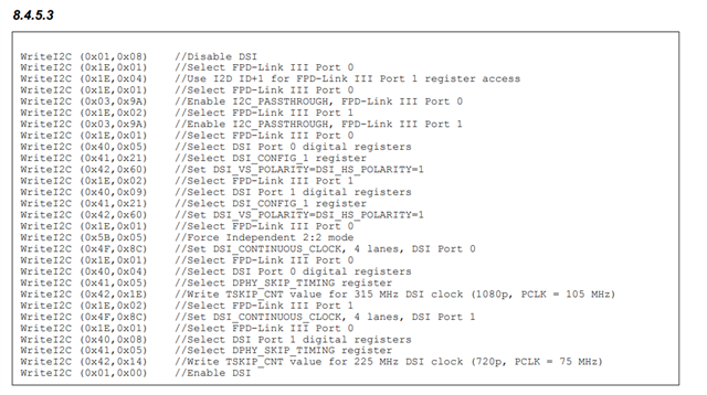

配置是:Single-Link Mode  ,4 Lane  1080p   DSI Port 0---->FPD-Link III Port 0
 如下这样配置正确吗?
{0x01,0x08}, //Disable DSI
{0x1E,0x01}, //Select FPD-Link III Port 0
{0x03,0x9A}, //Enable I2C_PASSTHROUGH, FPD-Link III Port 0
{0x40,0x05}, //Select DSI Port 0 digital registers
{0x41,0x21}, //Select DSI_CONFIG_1 register
{0x42,0x60}, //Set DSI_VS_POLARITY=DSI_HS_POLARITY=1
{0x5B,0x01}, //Single mode
{0x4F,0x8C}, //Set DSI_CONTINUOUS_CLOCK, 4 lanes, DSI Port 0
{0x40,0x04}, //Select DSI Port 0 digital registers
{0x41,0x05}, //Select DPHY_SKIP_TIMING register
{0x42,0x1E}, //Write TSKIP_CNT value for 315 MHz DSI clock (1080p, PCLK = 105 MHz)
{0x01,0x00}, //Enable DSI
