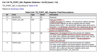

如上图连接,split mode下,941 port0通过i2c 0x2c slave addr可以访问这路948。将941 0x1e bit1 bit2置1选择port1,通过0x2d访问不了port1这路948,请问要怎么设置reg 才可以访问这路948?谢谢!
你好,如上描述,bit2 置1,port1 将通过DeviceID + 1 (7-bit format)访问,port0 0x2c,port1 0x2d,这样理解对吗?

如何建立port1链接,试下下面的配置:
Write reg0x1E = 0x01 //Select FPD-Link III Port 0
Write reg0x1E = 0x04 //To use I2C Device ID+1 for FPD-Link III Port 1 register access
Write reg0x03 = 0x9A //Enable I2C_PASSTHROUGH, FPD-Link III Port 0
Write reg0x1E = 0x02 //Select FPD-Link III Port 1
Write reg0x03 = 0x9A //Enable I2C_PASSTHROUGH, FPD-Link III Port 1
