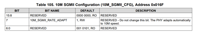

i use DP83867is to connect mac interface with sgmii . i only notice the method to foce the speed to 10M-sgmii with register 0x016f . but how to force the sgmii in 1000M speed .

0x16f:0x12

3.0x16f按照手册中的描述,配置值0x12应该没有效果啊?

3. 是的,这个寄存器是不需要配置的。
