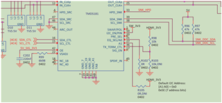

芯片硬件配置如下:引脚IIC_EN/PIN、TX_TERM_CTL拉高,VSADJ引脚接6.98K电阻接地,SDA_SRC/SCL_SRC接地;上电后,IIC不做配置,输入1080p30,视频正常输出;通过SDA_CTL/SCL_CTL向TMDS181寄存器0x0A配置为0xE3、0x0B配置为0x1B;输入1080p60、4K30色彩不对。

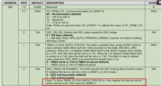

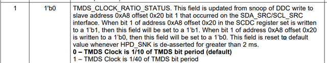

    按照这个寄存器的解释,需要通过I2C 将从机地址0XA8的offset 0x20的bit1写1。 datasheet中有这么一句解释:
    If a 1 is written, then the TMDS clock is set to 1/40th of TMDS bit period. If a 0 is written, then the TMDS clock is set to 1/10th of TMDS bit period. The TMDS181 defaults to 1/10th of TMDS bit period unless a 1 is written to address 0xA8 offset 0x20 bit 1. When HPD is deasserted, this bit is reset to default values. If the source does not write this bit, the TMDS181 will not be configured for TMDS clock 1/40th mode in support of HDMI2.0a(如果源端不对0x20 bit1 写1的话,TMDS181 不会配置为TMDS clock 1/40th mode )

    3、redriver mode 模式下,按照下图的硬件配置,在数据速率小于3.4Gbps时,不对寄存器配置,寄存器为默认状态,视频是否可以正常输出?多谢!

    3.  TMDS181 在频率小于100Mhz时,内部retimer mode会自动bypass,即工作在redriver mode,只有当时钟大于100Mhz时,会自动切换为retimer mode。
