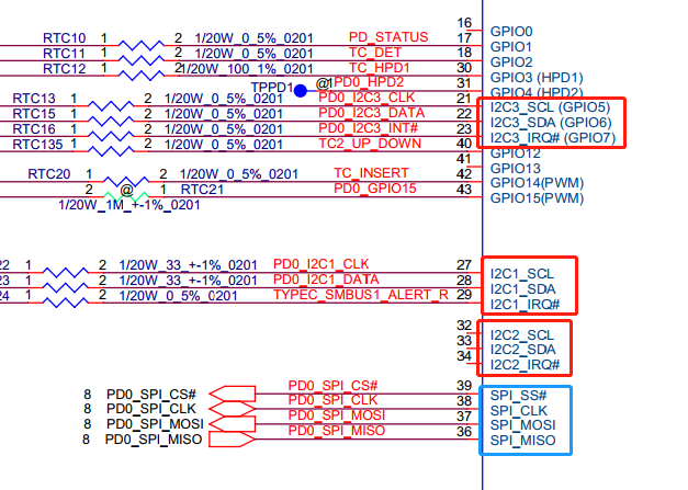

Our product is based on ARM (Qualcomm 865), Android 10;which use TPS65988 as PD solution.
Our customer asked that the PD firmware must be upgraded by software ways,it's forbiden to use a hardware tools to upgrade firmware.
We want to know if PD TPS65988 can be upgraded firmware by its I2Cs (I2C1,I2C2,I2C3),or you can suggested a software upgrade solution.
If PD support through I2C to upgrate firmware, please help share develop code which can be usd in Android.

One more thing, please help confirmed if all three I2C port can be used to upgrade Firmware? or only some one dedicated I2C could be used in upgrading?
