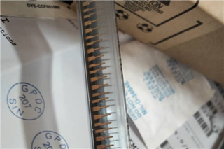

最近新买货 氧化现象,请帮确认是什么问题呢?
您好,
这是TI对 leadframe 工艺的改进,有更好的焊接粘附度,如果是在TI store购买的那么就没必要担心,下面链接有对这种现象的解释:
[FAQ] Why do the leadframes look strongly oxidized or corroded?:https://e2e.ti.com/support/logic-group/logic/f/logic-forum/718449/faq-why-do-the-leadframes-look-strongly-oxidized-or-corroded
