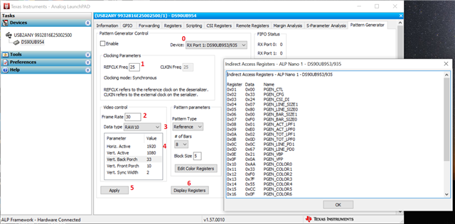

DS90UB954-Q1: 是否可以按照这个配置表,配置一份需求(CSI 4lan 接入1280X720 @ 60 , YUV422的格式)配置表
Part Number: DS90UB954-Q1
Other Parts Discussed in Thread: ALP, USB2ANY
//Patgen RGB888 1280x720p30 Fixed 8 Colorbar
{0xB0, 0x00},// Indirect Pattern Gen Registers
{0xB1, 0x01},// PGEN_ CTL
{0xB2, 0x01},
{0xB1, 0x02},// PGEN_ CFG
{0xB2, 0x33},
{0xB1, 0x03},// PGEN_ CSI_ DI
{0xB2, 0x24},// RGB888
{0xB1, 0x04},// PGEN_ LINE_ SIZE1 1280
{0xB2, 0x0F},
{0xB1, 0x05},// PGEN_ LINE_ SIZE0
{0xB2, 0x00},
{0xB1, 0x06},// PGEN_ BAR_ SIZE1 color bar
{0xB2, 0x01},
{0xB1, 0x07},// PGEN_ BAR_ SIZE0
{0xB2, 0E0},
{0xB1, 0x08},// PGEN_ ACT_ LPF1 720
{0xB2, 0x02},
{0xB1, 0x09},// PGEN_ ACT_ LPF0
{0xB2, 0xD0},
{0xB1, 0x0A},// PGEN_ TOT_ LPF1 800
{0xB2, 0x03},
{0xB1, 0x0B},// PGEN_ TOT_ LPF0
{0xB2, 0x20},
{0xB1, 0x0C},// PGEN_ LINE_ PD1 //30pfs
{0xB2, 0x10},
{0xB1, 0x0D},// PGEN_ LINE_ PD0
{0xB2, 0x47},
{0xB1, 0x0E},// PGEN_ VBP
{0xB2, 0x21},
{0xB1, 0x0F},// PGEN_ VFP
{0xB2, 0x0A},
