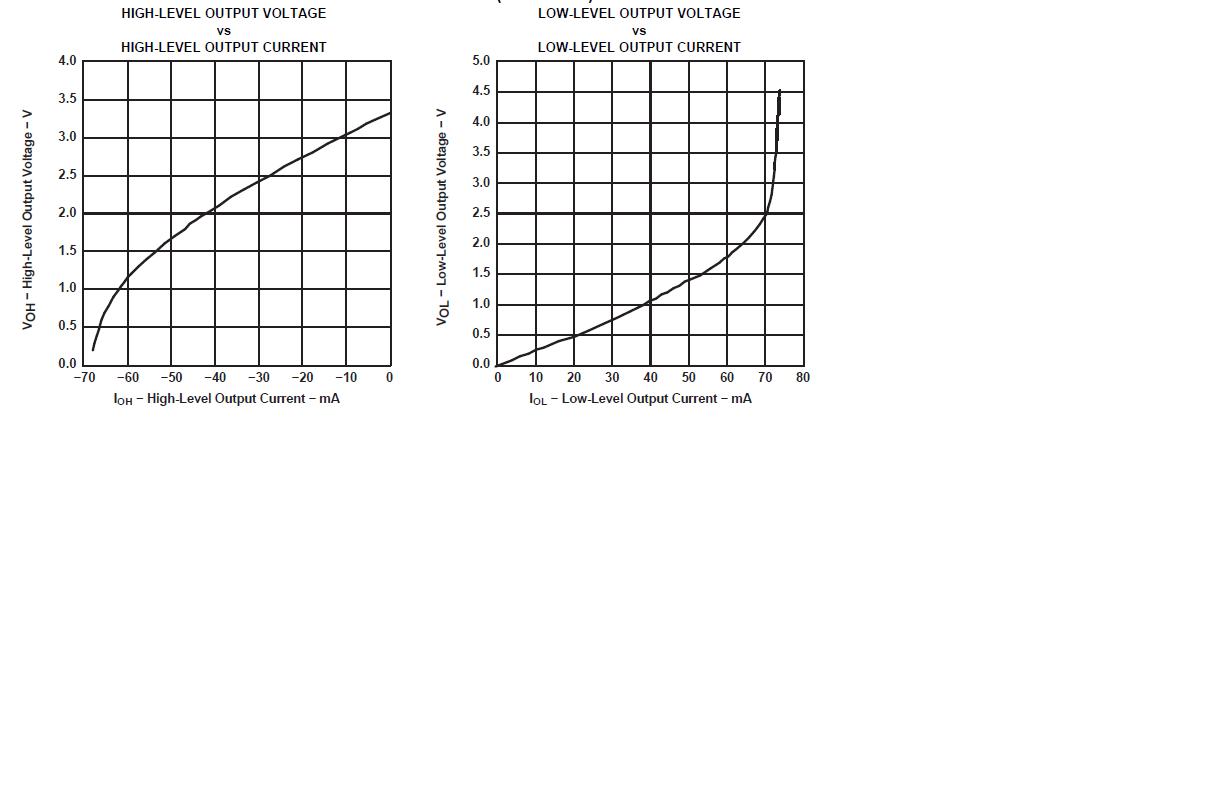

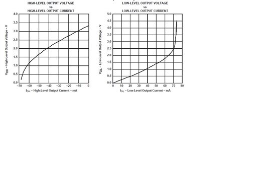

Hello,
I have some questions about SN65LVDT388a.
1. What is the driving capability of this LVDS Receiver?
2. Is it able to drive a 50 Ohm resistor? If not, is there any good ways to make it possible?
3. When you test it, what is the load? and what is the DC level voltage of the output?
Many thanks in advance!
