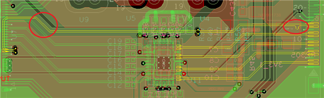

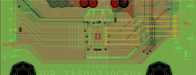

I use this SN65DP141,Lighting time,EDP screen flicker. If I Press input port with your finger,the flicker will disappear.
How should I solve this problem ?
this is PCB:

您好,我们可以直接中文沟通。
看了下PCB,有下面两处有疑问,左边的看起来线间距变窄,这样会影响信号完整性。
右边这里,可能是布线原因走不开,我看拐弯了,这样差分线的线长差比较大,也会影响信号完整性。
