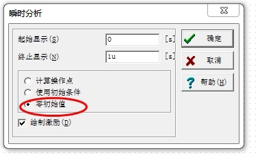

ne555做振荡器,仿真时出现错误。查看帮助后,得到下列信息。

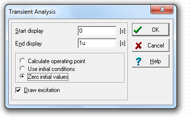

If you receive this error message for an Oscillator circuit at Transient Analysis make sure to set the "Zero Initial values" option in Transient Analysis dialog.
如何设置zero initial value?
