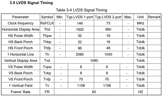

Ds90ub949-q1 is used with DS90UB948-Q1,hdmi output to ds90ub949, 948 output to screen, the screen is not displayed but the backlight of the screen is bright, and i2c can communicate with Ds90ub949-q1 and S90UB948-Q1.
T he pattern test is performed, the screen is also not displayed.
Perform the configuration according to 4.4 Cases in the SNLA132G document. Use the Without FPD-link III scheme and configure 948 to enter Pattern test. The screen displays no information.

How should I judge the problem?
How to make patgen work only on deserializers before using patgen via FPD-Link?

您配置的pattern 分辨率是1920x1080p,并且enable 外部clock模式。
Htotal: 2200
Vtotal: 1125
HActive: 1920
VActive: 1080
HBP: 148
VBP: 24
HSW: 44
VSW: 5
Positive polarity.
但是这个配置和屏幕的参数是不匹配的。
需要注意因为您已经enable 外部clock模式,那么948会期望来自于ser端的PCLK。所以如果949端没有HDMI输入的话,您需要更改为内部clock模式。
