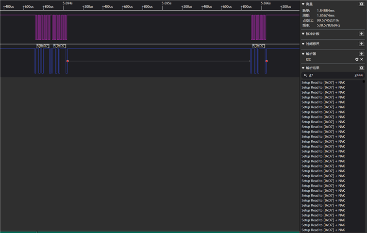

  • 断开主控和927的i2c 以及 940 和 其主控的I2C,   927 接上逻辑分析仪或示波器,  当927接入940, 927 马上发送数据,逻辑分析仪捉的数据如图
    我还是没太明白您的应用。927和940分别接主控吗?建议将应用框图附上便于分析。

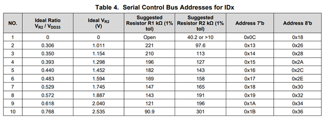

    927和940接,927马上发送数据,这里我理解的又是 Device--927--940--Host。 当927和940连接好之后,通过940确实可以读取到927的地址。但是927的10个可用地址没有D7这个地址,所以可以看到是NACK。把927的透传功能关掉呢?

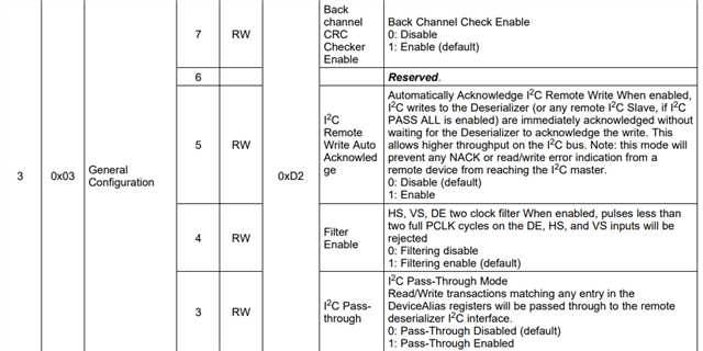

    It looks like bit 5 of the 0x04 register on the 927 controls "Clear back channel CRC Error Counters", which may clear the counter of errors on the system and not the errors themselves.
    927的0x04 bit5能清除error的数量,但是实际errors还是存在的。
    The assignment of 0xB0 to the register 0x03 would enable the back-channel CRC checker, I2C remote write auto acknowledge, and filter enable. With these settings, pulses with less than two full PCLK cycles (1/2 the PCLK frequency) are rejected, and I2C auto acknowledge will not wait for the deserializer (940) to acknowledge writes to devices. Can we confirm that the I2C communication bug is happening between the 927 and 940? Also, what is the frequency of the PCLK between the devices?
    寄存器0X03配置为0xB0使能back 通道的CRC checker。I2C远程会自动写应答,使能滤波。这些设置,脉冲信号小于两个完整的PCLK周期会被拒,并且I2C自动应答将不会等待940 写到devices的应答信号,我们是否能确认I2C 通讯问题发生在927和940之间吗?PCLK的频率是多少?
