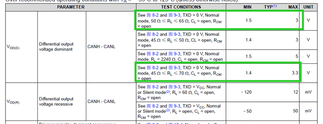

我们使用的TCAN1043DMTRQ1,在总线一致性测试时测出显性电平为3.12V,规格书中关于显性电平的定义如下图
我们当前RL是62Ω,上图中的RL=62Ω对应两个电压范围,如何判断这个测试是否通过?

您好,

1、差分输出电压的两个参数基于ISO 11898 -2 CAN标准文档中的正常总线负载和扩展总线负载定义,该文档将这两个特性作为单独的表项列出(表5)。
在正常总线负载情况下,输出电压高于3.0V不是期望的,但这与较高的差分无关,这有利于系统的信号完整性。您的测量结果与datasheet 存在差异可能是由于测量方法的差异,负载电阻差异或Vcc上的电压略高造成的。
The two datasheet parameters for differential output voltage are based to the normal bus load and extended bus load definitions in the ISO 11898-2 CAN standard document which lists these two characteristics as separate table items (table 5).
The output voltage higher than 3.0V in the normal bus load case is not expected, but is not concerning as a higher differential here is beneficial to the signal integrity of the system. The discrepancy may be due to a difference in measurement methods, load resistor variance, or a slightly higher voltage supply on Vcc.
