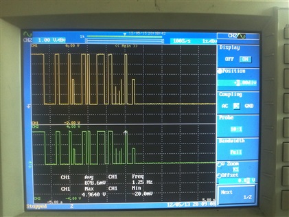

从您的图和描述看起来并不像是和TXB0104有关,当然也不能完全排除。您可以先看看您的5V端输出是不是出现问题了?
我现在基本确定是txb0104造成的,因为按我的程序应该只输出2个高电平,但从波器中看却非常乱,但如果我把5V转3.3V的那个通路断开,从示波器看AD输出就是2个高电平,非常正常,估计TXB0104对AD转换芯片造成了某种干扰导致AD工作不正常
TXB系列不推荐外加上拉,加的话也要在50k以上。
Pullup or Pulldown Resistors on I/O Lines
The TXB0104 is designed to drive capacitive loads of up to 70 pF. The output drivers of the TXB0104 have low
dc drive strength. If pullup or pulldown resistors are connected externally to the data I/Os, their values must be
kept higher than 50 kΩ to ensure that they do not contend with the output drivers of the TXB0104.
For the same reason, the TXB0104 should not be used in applications such as I2C or 1-Wire where an
open-drain driver is connected on the bidirectional data I/O. For these applications, use a device from the TI
TXS01xx series of level translators.
