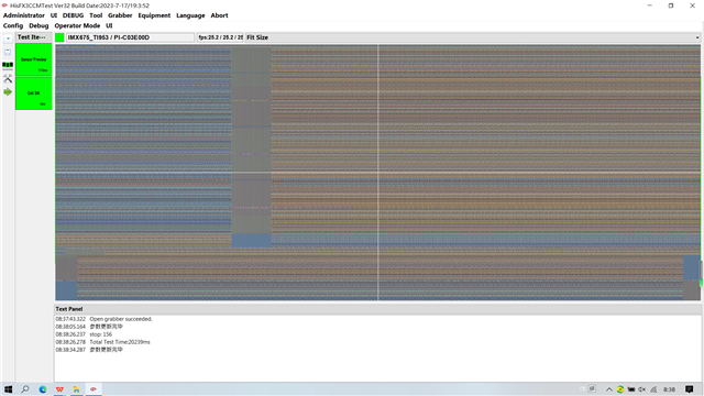

IMX675输出MIPI_4LANE+DS90UB953A-Q1,后端接DS90UB954,954接25M晶振,无法出图,将954寄存器0X58由0X5E改为0X5D,图像异常,现在无法解决,请问需要修改哪个寄存器才能图像正常
0x7a,0x4c,0x01
0x7a,0x20,0x20
0x7a,0x58,0x5e
0x7a,0x5c,0x32
0x7a,0x5d,0x34
0x7a,0x65,0x34
0x7a,0x5e,0xc0
0x7a,0x66,0xc0
0x7a,0x1f,0x02
0x7a,0x33,0x03
0x32,0x02,0x73
0x32,0x0e,0x3c
0x32,0x0d,0xc3
