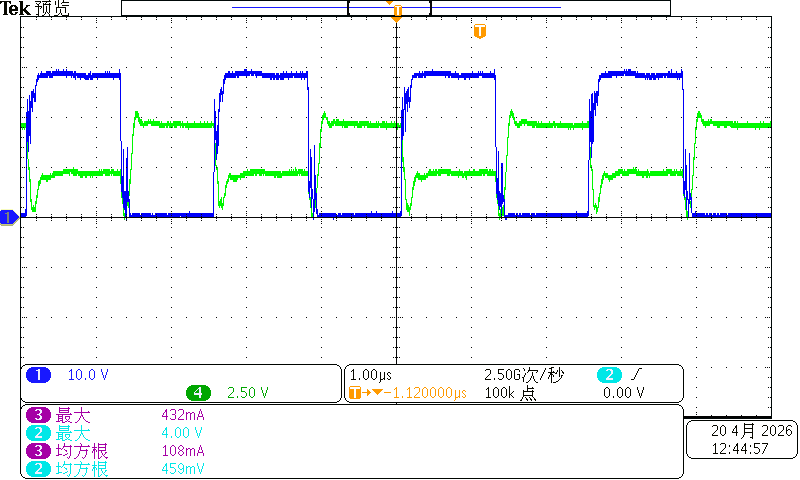

TIDA-00785: 使用tida-00785这个驱动出现问题
Part Number: TIDA-00785
我在使用tida-00785这个驱动方案时出现问题,图中绿色的是驱动GaN的Gs电压即Vgs,关断时不是零电压
  • 已经收到了您的案例,调查需要些时间,感谢您的耐心等待。
  • 您好
    When Q1 conducts, current is sourced from VIN into ground through the lower half of the primary of the transformer. This creates a negative potential at the lower half of the primary, winding with respect to the primary center tap. In order to maintain the previously established current through Q2 , which has now been opened, the upper half of the primary turns positive with respect to the center tap of the primary. This voltage is now transferred to the secondary of the transformer according to the dot convention and the turns ratio of the transformer. CR1 is now forward biased and CR2 is reverse biased; this in turn causes a current to flow through the upper half of the secondary, passing through CR1 into C charging the capacitor and back into the secondary center tap.
    根据这个说明,请检查以下D2 和C10/11的情况。
