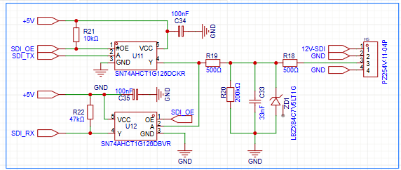

[参考译文] SN74LVC1G17:用作 SDI-12电压电平转换器的 SN74AHCT1G125 + SN74LVC1G17
Part Number: SN74LVC1G17
Hi,
We have received your post and the investigation will take some time. Thank you for your patience.
Is the intention of the design to be choosing between SDI_TX and SDI_RX?
I believe the bottom device (AHCT1G126) is connected wrong. SDI_RX is going into pin 4 (output Y). You should flip Pin 2 and Pin 4 connections.
