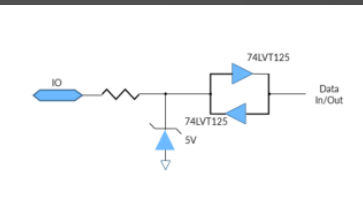

  How should the SN741VT125 be used? Does it support 3.3V output to 5V, or 5V input to 3.3V? The datasheet doesn’t seem to mention this kind of usage.
  The usage method is as follows. Please help check whether this approach is feasible. If not, could you recommend alternative chips?
