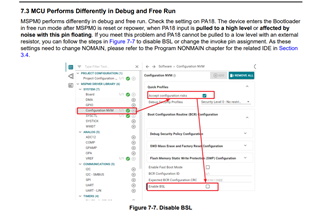

客户是否可以在调试模式下重现此问题? 此线程是否存在同样的问题? https://e2e.ti.com/support/microcontrollers/arm-based-microcontrollers-group/arm-based-microcontrollers/f/arm-based-microcontrollers-forum/1435860/mspm0l1306-hardware-reset-issue
请要求客户遵循此注释以禁用 ts 并重试 https://www.ti.com/lit/an/slaaed1d/slaaed1d.pdf?BSL=1731401851589
