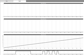

Task Testing shows no Event counter change
This image shows the task testing. We can see the GPIO is being manually pushed high and low. This is being detected in the execution code. We have an execution counter that we can see is rising. We have an event counter that remains at 0.
This means the event handler code is never being run. This proves that we have the right GPIO line because execution code is able to detect it changing.
Task testing sequence:
Initialisation code:
state.clickCount = 0;
state.inClickTrain = 0;
// Set up the first interrupt trigger
evhSetupGpioTrigger(0, AUXIO_I_CLICK_IN, 1, EVH_GPIO_TRIG_ON_EDGE);
// Schedule the next execution
fwScheduleTask(1);
执行代码:
// For debug: copy the GPIO value to a state variable.
gpioGetInputValue(AUXIO_I_CLICK_IN; state.gpioVal);
// For debug: keep a running count of how many times the execution code has run.
state.execCount += 1;
/***** other logic ******/
// Schedule the next execution.
fwScheduleTask(1);
EventHandlerA 代码:
state.eventCount += 1;
// Set up the next interrupt trigger

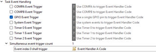

Task Event Handling Settings show GPIO Event Trigger ticked, and event 0 shall trigger Event Handler A code

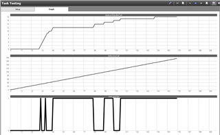

    更新:
    当我们删除使用2个事件的另一个任务时、我们的任务代码正常工作。 另一个任务仅使用 timer2事件触发器、而不使用 GPIO。
    我的理解是、因为它是在一个单独的任务中、那么具有相同的索引号应该无关紧要、这是正确的吗?
    在尝试设置基本的 GPIO 触发器时、我重现了您的问题
    我也会尝试使用 仅使用两个事件处理程序的一个任务 (计时器和 GPIO)、也可以尝试一下 将 GPIO 任务在执行顺序中移至更高的位置。
    我在这里链接我的项目,这样也许你可以看到与你的不同。
    e2e.ti.com/.../GPIO_5F00_input.zip
    Maxence
    感谢您的快速响应、Maxence、
    确实是 任务执行顺序很重要 我们现在能够触发这个中断。
    再次感谢!
