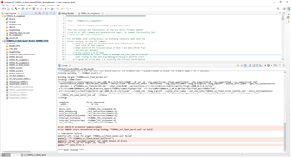

    我执行了您所说的操作、但仍然有一些错误:
    **** Build of configuration BANK0_LDFU for project f28002x_sci_flash_kernel ****
    "C:\\ti\\ccs1031\\ccs\\utils\\bin\\gmake" -k -j 8 all -O
    Building target: "f28002x_sci_flash_kernel.out"
    Invoking: C2000 Linker
    "C:/ti/ccs1031/ccs/tools/compiler/ti-cgt-c2000_20.2.4.LTS/bin/cl2000" -v28 -ml -mt --cla_support=cla2 --float_support=fpu32 --idiv_support=idiv0 --tmu_support=tmu0 --vcu_support=vcu0 -Ooff --define=checksum_enable --define=_DUAL_HEADERS --define=_FLASH --define=LIVE_UPDATE --define=CPU1 --diag_suppress=10063 --diag_warning=225 --diag_wrap=off --display_error_number --gen_func_subsections=on --abi=eabi -z -m"f28002x_sci_flash_kernel.map" --stack_size=0x100 --warn_sections -i"C:/ti/ccs1031/ccs/tools/compiler/ti-cgt-c2000_20.2.4.LTS/lib" -i"C:/ti/c2000/C2000Ware_3_03_00_00/libraries/flash_api/f28002x/lib" -i"C:/ti/ccs1031/ccs/tools/compiler/ti-cgt-c2000_20.2.4.LTS/include" --reread_libs --diag_wrap=off --display_error_number --xml_link_info="f28002x_sci_flash_kernel_linkInfo.xml" --entry_point=bankSelect --rom_model -o "f28002x_sci_flash_kernel.out" "./SCI_Boot_f28002x.obj" "./SCI_GetFunction_f28002x.obj" "./f28002x_lfu_singlebank.obj" "./f28002x_sci_flash_kernel.obj" "./f28002x_sysctrl.obj" "../28002x_lfu_flash_kernel_lnk.cmd" "C:/ti/c2000/C2000Ware_3_04_00_00/libraries/flash_api/f28002x/lib/FlashAPI_F28002x_FPU32.lib"  -llibc.a
    <Linking>
    "../28002x_lfu_flash_kernel_lnk.cmd", line 83: error #10008-D: cannot find file "FlashAPI_F28002x_FPU32.lib"
     undefined                 first referenced
      symbol                       in file
     Device_init               ./f28002x_lfu_singlebank.obj
     GPIO_setPadConfig         ./SCI_GetFunction_f28002x.obj
     GPIO_setPinConfig         ./SCI_GetFunction_f28002x.obj
     GPIO_setQualificationMode ./SCI_GetFunction_f28002x.obj
     Interrupt_initModule      ./f28002x_lfu_singlebank.obj
     Interrupt_initVectorTable ./f28002x_lfu_singlebank.obj
     SCI_setConfig             ./SCI_GetFunction_f28002x.obj
    error #10234-D: unresolved symbols remain
    error #10010: errors encountered during linking; "f28002x_sci_flash_kernel.out" not built
    >> Compilation failure
    makefile:146: recipe for target 'f28002x_sci_flash_kernel.out' failed
    gmake[1]: *** [f28002x_sci_flash_kernel.out] Error 1
    gmake[1]: Target 'secondary-outputs' not remade because of errors.
    makefile:142: recipe for target 'all' failed
    gmake: *** [all] Error 2
    **** Build Finished ****
    你认为我还缺少什么?
    Wilson

    这个项目和构建配置在我的系统上构建良好。 它仍在抱怨 无法在您的构建中找到 FlashAPI_F28002x_FPU32.lib。 您能否检查您的 C2000Ware 安装并查看此文件是否在预期位置?
    您使用的是哪个版本的 C2000Ware?
    Sira
    Sira、
    正如您在其中一个屏幕截图中看到的、我将在项目中直接包含 FlashAPI_F28002x_FPU32.lib。
    我的笔记本电脑上的 C2000Ware 版本是 C2000Ware_3_04_00_00。
    Wilson

    Wilson
    Wilson、
    我尝试切换到 C2000Ware v3.04、即使这样也能正常工作。
    您能否如下图所示检查项目的链接资源?
    SIA、
    这完全不同、但我不知道如何解决。
    可以帮帮我吗?
    Wilson

    这就是我的项目浏览器的外观。
    因此、我不知道还需要做什么来修复它。
    Wilson
    Wilson、
    我无法理解它是如何或为什么在您的第一张图片中生成这些未找到的文件错误的。
