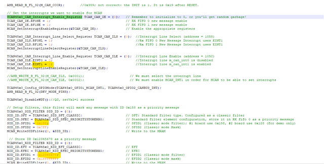

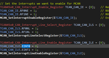

    TCAN45x_Init.c 文件此处启用了 m_CAN_INT1、这意味着 GPO2被选中中断。
    SFID1的作用是根据下图对 CAN 信号进行滤波的作用是什么?0x158那么我只能给出0x148、0x118、0x140、0x110、0x048、0x040的信号、但是信号不应该是0x284、0x424是正确的?
    我无法读取此 CAN 信号0x284和0x424是否正确?

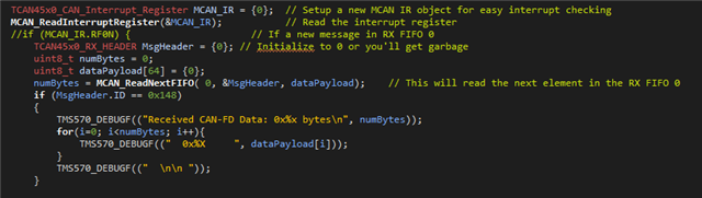

    如何生成多个发送 CANFD 和多个接收信号。
    如果发送为2,那么我需要将 M_CAN_TXBAR 3从1更改为1?
    AHB_WRITE_B_FL_32 (M_CAN_TXBAR、0x0000000003);
    同样,如何使用 MCAN_ReadNextFIFO 读取多个接收 CANFD 信号?
            if(1)
                MCAN_WriteTXFIFO(0, &header1, &g_ucADC1Data[g_ucCurrentAdcDataIndex][0]);
                AHB_WRITE_B_FL_32(M_CAN_TXBAR, 0x0000000001);
    			TCAN45x0_CAN_Interrupt_Register MCAN_IR = {0};  // Setup a new MCAN IR object for easy interrupt checking
                MCAN_ReadInterruptRegister(&MCAN_IR);           // Read the interrupt register
                //if (MCAN_IR.RF0N) {                     // If a new message in RX FIFO 0
                    TCAN45x0_RX_HEADER MsgHeader = {0}; // Initialize to 0 or you'll get garbage
                    uint8_t numBytes = 0;
                    uint8_t dataPayload[64] = {0};
                    numBytes = MCAN_ReadNextFIFO( 0, &MsgHeader, dataPayload);    // This will read the next element in the RX FIFO 0
    				if (MsgHeader.ID == 0x148)
    					TMS570_DEBUGF(("Received CAN-FD Data: 0x%x bytes\n", numBytes));
    					for(i=0; i<numBytes; i++){
    						TMS570_DEBUGF(("  0x%X     ", dataPayload[i]));
    					TMS570_DEBUGF(("  \n\n "));
    提前感谢。

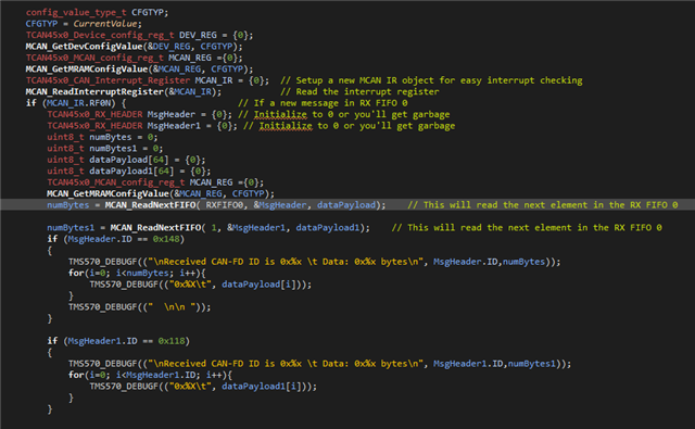

    您好
    我不确定使用 RXFIFO 0和 RXFIFO 1只能使用 RX FIFO 和 RX 缓冲器来读取多个 CAN FD 信号。
    我无法在索引处读取 FIFO 的 RXF1S 寄存器
    我在下面共享了我的代码、请检查它、并告诉我如何修改以读取多个 CANFD 信号。
    config_value_type_t CFGTYP;
    CFGTYP = CurrentValue;
    TCAN45x0_Device_config_reg_t DEV_REG = {0};
    MCAN_GetDevConfigValue(&DEV_REG, CFGTYP);
    TCAN45x0_MCAN_config_reg_t MCAN_REG ={0};
    MCAN_GetMRAMConfigValue(&MCAN_REG, CFGTYP);
     TCAN45x0_RX_HEADER MsgHeader1 = {0}; // Initialize to 0 or you'll get garbage
     uint8_t numBytes1 = 0;
     uint8_t dataPayload1[64] = {0};
     numBytes = MCAN_ReadNextFIFO( RXFIFO0, &MsgHeader, dataPayload);    // This will read the next element in the RX FIFO 0
     numBytes1 = MCAN_ReadNextFIFO( 1, &MsgHeader1, dataPayload1);    // This will read the next element in the RX FIFO 0
     	TMS570_DEBUGF(("\nReceived CAN-FD ID is 0x%x \t Data: 0x%x bytes\n", MsgHeader.ID,numBytes));
     		TMS570_DEBUGF(("0x%X\t", dataPayload[i]));
     if (MsgHeader1.ID == 0x118)
         TMS570_DEBUGF(("\nReceived CAN-FD ID is 0x%x \t Data: 0x%x bytes\n", MsgHeader1.ID,numBytes1));
         for(i=0; i<MsgHeader1.ID; i++){
             TMS570_DEBUGF(("0x%X\t", dataPayload1[i]));
    请尽快回复我。
    提前感谢。
    您好、Santhosh、
    默认情况 下、任何接收到的与现有 ID 滤波器不匹配的消息都将存储在 RXFIFO0中(请参阅 TCAN4x5x_MCAN_Global_Filter_Configuration)。 此 FIFO 中的新消息将由  MCAN_IR.RF0N 中断指示。 如果滤波器已配置为在  RXFIFO1中存储接收到的具有特定 ID 的消息、则新消息将通过  MCAN_IR.RF1N 中断指示。  使用两个 FIFO 接收消息的伪代码如下所示:
    // define receive variables
    // if message received in RXFIFO0
    if (MCAN_IR.RF0N) {
    	// Read RXFIFO0
    // if message received in RXFIFO1
    else if (MCAN_IR.RF1N) {
    	// Read RXFIFO1
    	numBytes = MCAN_ReadNextFIFO( RXFIFO1, &MsgHeader, dataPayload);
    // handle received message
    if(MsgHeader.ID == 0x48) {
    	// handle case
    else if(MsgHeader.ID == 0x118) {
    	// handle case
    Eric Schott

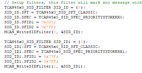

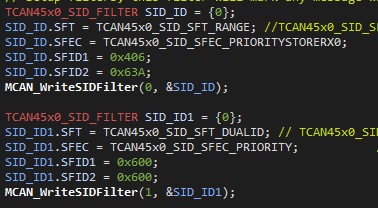

    是的、我已经为 CAN ID 接收信号配置了 SID 滤波器。
        TCAN45x0_SID_FILTER SID_ID = {0};
        SID_ID.SFT = TCAN45x0_SID_SFT_CLASSIC;
        SID_ID.SFEC = TCAN45x0_SID_SFEC_PRIORITYSTORERX0;
        SID_ID.SFID1 = 0x0D5;
        SID_ID.SFID2 = 0x7FF;
        MCAN_WriteSIDFilter(0, &SID_ID);
        TCAN45x0_SID_FILTER SID_ID1 = {0};
        SID_ID1.SFT = TCAN45x0_SID_SFT_CLASSIC;
        SID_ID1.SFEC = TCAN45x0_SID_SFEC_PRIORITYSTORERX1;
        SID_ID1.SFID1 = 0x77F;
        SID_ID1.SFID2 = 0x7FF;
        MCAN_WriteSIDFilter(1, &SID_ID1);
    SID_ID:SFID1 = 0x0D5将允许041和0D5
    SID_ID1:SFID1 = 0x77F 将允许473、34A 和344
    RXFIFO 0和 RXFIFO 1的代码
    接收 SCI UART 输出的输出仅为0x041 CAN 信号。
    请帮助我找到问题、为什么我无法在接收端获取另一个 CAN ID 信号
    我是否需要修改 TCAN4x5x Init 设置?
    提前感谢。
    桑托什

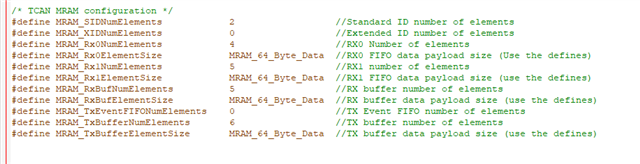

    MRAM 是否已配置为存储两个 SID 过滤器? 演示代码只分配一个 SID 和一个 XID 滤波器元素(下面的第12 - 13行)。 由于您使用两个 SID 滤波器元素、因此需要对其进行调整。 未使用的 XID 滤波器元素也应未分配、因为未配置的元素可能会导致未定义的行为。
    还要确保 FIFO 元件已正确配置、以存储接收到的数据。
    	 * In the next configuration block, we will set the MCAN core up to have:
    	 *   - 1 SID filter element
    	 *   - 1 XID Filter element
    	 *   - 5 RX FIFO 0 elements
    	 *   - RX FIFO 0 supports data payloads up to 64 bytes
    	 *   - RX FIFO 1 and RX Buffer will not have any elements, but we still set their data payload sizes, even though it's not required
    	 *   - No TX Event FIFOs
    	 *   - 2 Transmit buffers supporting up to 64 bytes of data payload
    	TCAN4x5x_MRAM_Config MRAMConfiguration = {0};
    	MRAMConfiguration.SIDNumElements = 1;						// Standard ID number of elements, you MUST have a filter written to MRAM for each element defined
    	MRAMConfiguration.XIDNumElements = 1;						// Extended ID number of elements, you MUST have a filter written to MRAM for each element defined
    	MRAMConfiguration.Rx0NumElements = 5;						// RX0 Number of elements
    	MRAMConfiguration.Rx0ElementSize = MRAM_64_Byte_Data;		// RX0 data payload size
    	MRAMConfiguration.Rx1NumElements = 0;						// RX1 number of elements
    	MRAMConfiguration.Rx1ElementSize = MRAM_64_Byte_Data;		// RX1 data payload size
    	MRAMConfiguration.RxBufNumElements = 0;						// RX buffer number of elements
    	MRAMConfiguration.RxBufElementSize = MRAM_64_Byte_Data;		// RX buffer data payload size
    	MRAMConfiguration.TxEventFIFONumElements = 0;				// TX Event FIFO number of elements
    	MRAMConfiguration.TxBufferNumElements = 2;					// TX buffer number of elements
    	MRAMConfiguration.TxBufferElementSize = MRAM_64_Byte_Data;	// TX buffer data payload size

    RXFIFO 0配置为
    我正在接收 RXFIFO 0数据0x055和0x54,但它也允许0x474在 RXFIFO 中的实现方式是怎样的?
    SFID1 = 0x0D5
    SFID2 = 0x7FF
    匹配的应为0x051和0x0C5。
    不匹配 的应为0x474。

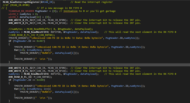

    RXFIFO1缓冲器中的 RF1N 没有更新
    请与我分享 RXFIFO 缓冲区更新的配置?

    如何 配置为在  RXFIFO1和 RX 缓冲器中接收 CAN 信号。 因为我已经为 RXFIFO 0和 RXFIFO 1配置了 SFD 滤波器、但无法从 RF1N 接收任何 CAN 信号为1、只有在 RF0N 中接收1并接收 CAN 信号。
    如何 配置 这个 MRAM 配置是 SID 和 XID 用于发送和接收 CAN 信号吗?
    Rx0NumElements  用于接收  CAN 信号的数量。
    Rx0ElementSize 为48字节是否可以分配第1个 CAN 信号从 Rx0ElementSize 的这个0位置开始、第2个 CAN 信号从 Rx0ElementSize 的这个第8个位置开始?
    类似地、在 RxBufNumElements 中要配置。
    请与我分享 RXFIFO1缓冲区和 RXBuffer 的更新配置?
    是否可以同时配置 RXFIFO 和 RXbuffer?

    此处显示的滤波器配置看起来正确。 这定义了两个标准 ID 滤波器、它们将在 FIFO0中存储接收到的 ID = 0x0D5的帧、在 FIFO1中存储 ID = 0x77F 的帧。 在给定中断处理代码的情况下、0x77F 似乎不是预期接收的 ID。 是否需要将第二个筛选器配置为接受一系列 ID? 如果是、请使用滤波器 SFT 的范围滤波器设置。

    此处显示的滤波器配置看起来正确。 这定义了两个标准 ID 滤波器、它们将在 FIFO0中存储接收到的 ID = 0x1D5的帧、在 FIFO1中存储 ID = 0x77F 的帧。 在给定中断处理代码的情况下、0x77F 似乎不是预期接收的 ID。 是否需要将第二个筛选器配置为接受一系列 ID? 如果是、请使用滤波器 SFT 的范围滤波器设置。

    我已经将滤波器设计为 标准滤波器类型 SFT、将2b01设计为双 ID 滤波器、但它工作正常。
    RXFIFO0只允许0x400、RXFIFO 1只允许0x600、但它接受0x100、这也是可能的。
    接收到的 CAN ID 0x400和0x100。 它应该只接受0x400 CANID 信号。
    桑托什·昌德拉霍恩
    如何只配置两个 CAN ID、一个在 RXFIFO0中、另一个在 RXFIFO1中
    RXFIFO0中的 CANID 0x200需要读取 、 而 RXFIFO1中的 CANID 0x600需要读取、现在情况更好。
    请指导我如何配置这两个 CAN 信号、这是一个紧急情况。
    提前感谢。
    RXFIFO0中的 CANID 0x407需要读取 、 而 RXFIFO1中的 CANID 0x600需要读取、现在情况更好。
    请指导我仅配置需要接收 CAN ID 407和600的2个 CANID 信号。
    更好的方法是 RXbuffer 或 RXFIFO、用于2个 CANID 信号和 CANFD 64字节数据。
     TCAN45x0_MRAM_Config
    2. SID 过滤器

    我在 TCAN4550中有一个直接的问题:接收 CAN ID、RXFIFO 0工作正常、但我无法接收 RXFIFO 1和 RX 缓冲器。 请帮我处理 RXFIFO 1和 RXbuffer 配置的演示代码以及接收代码支持、这已经足够了。

    我已通过在  TCAN45x 中添加带有 TCAN45x 全局滤波器结构的" TCAN45x0_ConfigureGlobalFilter " API 来解决了主要问题
     它在初始化中在 TCAN45x_Init API 中调用。 现在、SID 滤波器和 RXFIFO 1缓冲器都工作正常。

    RX 缓冲器可被配置为保持的元件数量范围为0至64个元件。 对于允许的元件数量、RX FIFO 具有相同的范围。 请记住、MRAM 的数量仍然有限(2kB)、因此、例如、如果每个元素配置为64字节、则64个元素将不可能。 相同的存储器需要能够适应滤波器元件、RX FIFO 和缓冲器元件以及 TX FIFO 和缓冲器元件。
    Eric Schott

    RXFIFO 或 RXBUFFER 应配置为保存最大预期有效载荷。 当器件接收到较小的有效载荷时、额外的空间将留空。 接收到的帧将存储数据长度代码、因此您可以在读取前确定有效载荷的大小。
