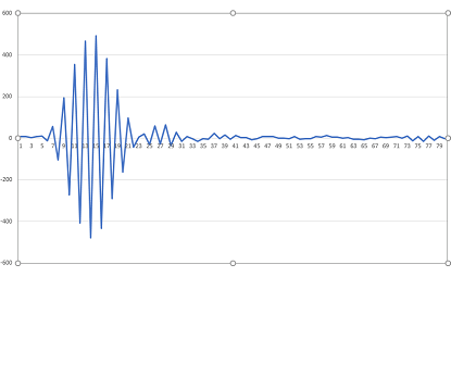

    更改与演示(UltrasonicWaterFR6047_02_10_00_05)相比的参数如下:
    #define USS_GAIN_RANGE USS_Capture_GAIN_Range_4_4.
    #define USS_START_CAPTURE_SEC 300000e-9
    #define USS_ADC_SAMP_COUNT_SEC 356000e-9
    #define USS_RESTON_CAP_COUNT_SEC 3000E-6
    #define USS_NUM_OF_DEALOG_TANESS_F1 4.
    #define USS_PGA_IN_BIAS_COUNT_SEC (295000e-9)
    #define USS_TON_ADC_COUNT_SEC (295000e-9)
    #define USS_TIME_OUT_COUNT_SEC (3000E-6)
    #define USS_HSPLL_USSXTAL_Setting_USEC (1800)
    ADC 采集图:
    尊敬的 Andy:
    ADC 捕获和信号增益良好。 您是否尝试在 USS 设计中心动态调整仪表相关的配置参数?
