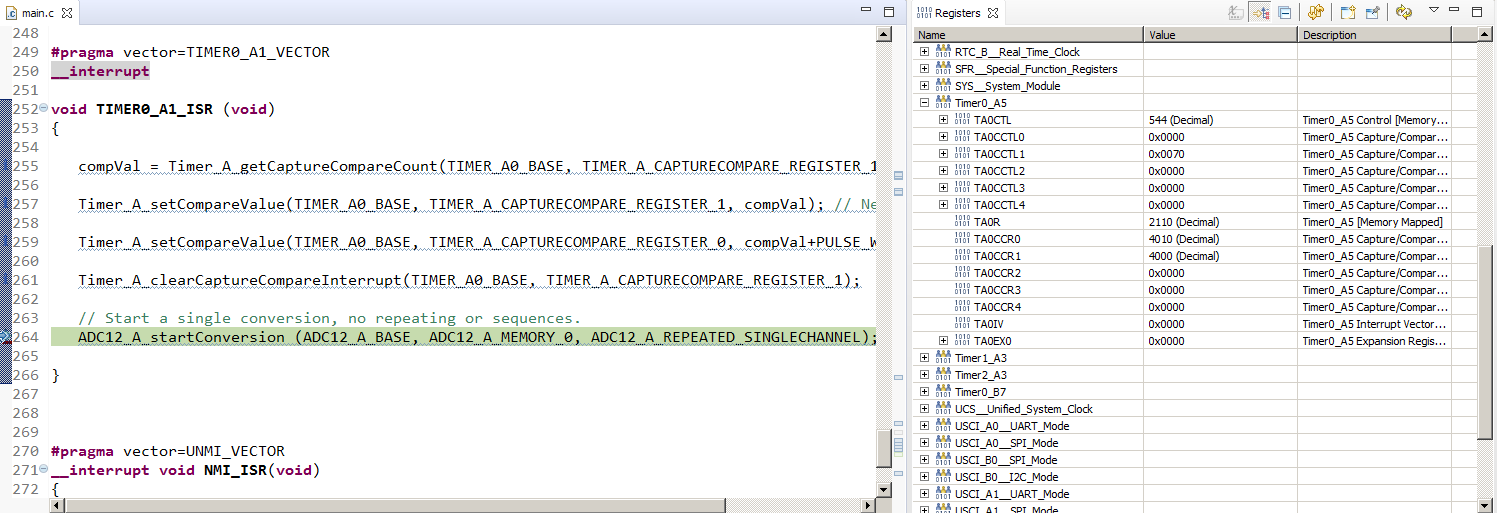

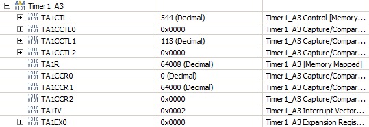

    您好、Britta、
    如果您参考数据表中的 ADC12SHSx、我可以看到计时器 A0链接到 ADC12_A_SAMPLEHOLDSOURCE_1
    那么我的 ADC init 语句 :
      ADC12_A_init (
             ADC12_A_base、
             ADC12_A_SAMPLEHOLDSOURCE_1、
             ADC12_A_CLOCKSOURCE_ADC12OSC、
             ADC12_A_CLOCKDIVIDER_1
    但代码似乎不起作用。
    #include "driverlib.h"
    //- -#define
    #define ADCpin GPIO_PORT_P6、GPIO_PIN0 //端口6引脚0
    #define No_of _Samples 32 //喜欢抓取32个样本
    #define COMPARE_VALUE 50000
    //相关时钟
    #define MCLK_REFOD_FREQUENCY IN_kHz 16000 // MCLK 主时钟(CPU)= 16MHz
    #define COMPARE_LLRLL_CALCFFEFFT / FREE_FREE/ FREE/ FREE= 32.768kHz (
    FLL_FREE/ FREE/ FREE/ FREE/ FREE/ FREE/ FREE/ FREE/ FREE/ FREE/ FREE/ FREE= 32.768kHz)
    -void void setupADC (void);void initTimer (void);void initClocks (void);//--globals volatile uint16_t DATA[No_for_Samples];// ADC Data uint32_t MCLK = 0;//MCLK uint32_t smclk = 0;//SMCLK uint32_t 状态
    = 0;/t intruint32;/uintuat_t uintma-void = 0
    //停止看门狗计时器
    WDT_A_HOLD (WDT_A_base);
    //设置时钟
    initClocks();
    //验证时钟设置是否符合预期
    MCLK = UCS_getMCLK ();
    aclk = UCS_getACLK ();
    smclk = UCS_getSMCLK ();
    //计时器设置
    initTimer();
    //ADC 设置
    setupADC();
    //启用全局中断
    _bis_SR_register (GIE);
    __no_operation();//对于调试
    器}
    //设置以 SMCLK
    void initTimer(void){为源的连续模式计时器
    Timer_A_initContinuousModeParam ={0};
    param.clockSource = TIMER_A_CLOCKSOURCE_SMCLK;
    param.clockSourceDivider = TIMER_A_CLOCKSOURCE_divider;
    param.timerInterruptEnable_TAIE = TIMER_A_TAIE_INTERRUPT_DISABLE;
    param.timerClear = timer_a_do _clear;
    param.startTimer = false;
    Timer_A_initContinuousMode (timer_A0_BASE、&param);
    //初始化比较模式
    Timer_A_clearCaptureCompareInterrupt (timer_A1_base、timer_A_CAPTURECOMPARE 寄存器_0);
    Timer_A_initCompareModeinitCompParam ={0};
    initCompParam.compareRegister
    initCompParam.compareValue = TIMER_A_CAPTURMPARE 寄存器0;initCompParam.compareInterruptEnable = TIMER_A_URECOMPE_= initCompParam.compareOutputMode;TIMER_OUTAULT_INTERRUT_TALT_TAMOUNT =
    Timer_A_initCompareMode (timer_A1_base、&initCompParam);
    Timer_A_startCounter (timer_A1_base、timer_A_Continuous_mode);
    //-setup 系统时钟
    //设置 DCO FLL 基准= REFO
    UCS_initClockSignal (
    UCS_FLLREF、 频率锁定环路的//基准
    UCS_REFOCLK_SELECT、//选择32.768kHz 基准振荡器
    UCS 时钟分频器1
    //设置 ACLK = REFO 设置辅助时钟
    UCS_ACLK、
    UCS_REFOCLK_SELECT、
    UCS 时钟分频器1
    //启动 FLL 并让其稳定下来
    //这将自动成为 MCLK 和 SMCLK
    //设置所需的频率并加载比率
    UCS_initFLSettle (
    MCLK_REVed_frequency in_kHz、
    MCLK_FLLREF_Ratio
    //启用全局振荡器故障标志
    SFR_clearInterrupt (
    SFR_Oscillator_FAULT_INTERRUPT
    SFR_enableInterrupt (
    //--setup ADC
    //设置 ADC 引脚
    GPIO_setPeripheralModuleFunctionInputPin (ADCpin);
    //初始化 ADC12_A 模块
    /* ADC12_A 模块的基地址
    *使用内部 ADC12_A 位作为采样/保持信号来启动转换
    *使用 ADC12OSC 5MHZ 内部数字振荡器作为时钟源
    *使用默认的时钟分频器1
    ADC12_A_init (
    ADC12_A_base、
    ADC12_A_ENABLE (ADC12_A_base);
    //将采样计时器设置为采样保持64个时钟周期
    /* ADC12_A 模块的基地址
    *对于内存缓冲区0-7采样/保持、持续64个时钟周期
    *对于内存缓冲区8-15个采样/保持、持续64个时钟周期
    *禁用多路采样
    ADC12_A_setupSamplingTimer()
    ADC12_A_base、
    ADC12_A_CYCLEHOLD_64_CYCLES、
    ADC12_A_CYCLEHOLD_4_CYCLES、
    ADC12_A_MULTIPLESAMPLESENABLE
    //使用指定的基准电压配置存储器缓冲器
    /* ADC12_A 模块的基地址
    *配置内存缓冲区0
    *将输入 A12映射到存储器缓冲器0
    * VREF+= VREF+(内部)
    * Vref-= AVSS
    *内存缓冲区0不是序列的末尾
    ADC12_A_configureMemoryParam param ={0};
    param.memoryBufferControlIndex |= ADC12_a_memory_0;
    param.inputSourceSelect |= ADC12_A_INPUT_A0;
    param.positiveRefVoltageSourceSelect |= ADC12_A_VREFPOS_AVCC;
    param.inveRefVoltageSourceSelect |= ADC12_A_VREFNEG_AVSS;
    param.endOfSequence |= ADC12_A_NOTENDOSEQUENCE;
    ADC12_A_configureMemory (ADC12_A_base、&param);
    //启用存储器缓冲器0中断
    ADC12_A_clearInterrupt (ADC12_A_base、ADC12IE0);
    ADC12_A_enableInterrupt (ADC12_A_base、ADC12IE0);
    //开始单次转换,无重复或序列。
    ADC12_A_startConversion (ADC12_A_base、ADC12_A_MEMORY_0、ADC12_A_RESPOND_SINGLECHANNEL);
    #pragma vector = ADC12_vector
    __interrupt void ADC12_ISR (void)
    静态 uint8_t 索引= 0;
    switch (__evo_in_range (ADC12IV、34)){
    情况0:中断;//Vector 0:无中断
    情况2:中断;//Vector 2:ADC 溢出
    情况4:中断;//矢量4:ADC 时序溢出
    案例6: //向量6:ADC12IFG0
    //移动结果
    DATA[index]= ADC12_A_getResults (ADC12_A_base、ADC12_A_MEMORY_0);
    //递增结果索引,模数;
    //set Breakpoint1此处并观察结果[]
    索引++;
    如果(索引==32)
    索引= 0;
    情况8:中断;//Vector 8:ADC12IFG1
    情况10:中断;//Vector 10:ADC12IFG2
    情况12:中断;//向量12:ADC12IFG3
    案例14:中断;//Vector 14:ADC12IFG4
    情况16:中断;//向量16:ADC12IFG5
    情况18:中断;//Vector 18:ADC12IFG6
    情况20:中断;//Vector 20:ADC12IFG7
    情况22:中断;//Vector 22:ADC12IFG8
    情况24:中断;//Vector 24:ADC12IFG9
    情况26:中断;//Vector 26:ADC12IFG10
    情况28:中断;//Vector 28:ADC12IFG11
    情况30:中断;//Vector 30:ADC12IFG12
    情况32:中断;//Vector 32:ADC12IFG13
    案例34:中断;//Vector 34:ADC12IFG14
    默认值:break;
    #pragma vector=Timer1_A0_vector
    __interrupt
    void Timer1_A0_ISR (void)
    uint16_t compVal = Timer_A_getCaptureCompareCount (timer_A1_base、timer_A_CAPTURECMOLE_REGISTER_0)+ COMPARE_VALUE;
    //Toggle P1.0 //上面有绿色 LED
    GPIO_toggleOutputOnPin (
    GPIO_PORT_P1、
    GPIO_PIN0

    您好、Bruce、
    ADC 根本不会被触发。
    以下快照单步进入代码。
    initTimer()之后的寄存器视图(在 main 中):
    寄存器视图(如下所示)、因为它首次达到 Timer1_A1_ISR ()。
    计时器 ISR 末尾的寄存器视图

    根据数据表(SLAS700D)、表6-14、SHS=1为 TA0.1、而不是 TA1.1。 我看不到任何与 TA1相关的 SHS 设置。
    您应该在整个过程中使用 TIMER_A0 (及其 CCR1)。 我想我错过了您何时进行该更改。
    未经请求:
    > compVal = Timer_A_getCaptureCompareCount (timer_A1_base、timer_A_CAPTURECMOLE_REGISTER_1)+ COMPARE_VALUE;
    > Timer_A_setCompareValue (timer_A1_base、timer_A_CAPTURECOMPARE 寄存器_1、compVal+COMPARE_VALUE);
    这是双递增的。 这现在不是您的错误、但它最终会出现。
    您好、Bruce、
    我在之前的帖子中提到了这一点(显示了 TA0连接的表格)。
    无论如何、我已恢复使用 TIMER_A0、并且 ADC 似乎正在触发。

    您好、Bruce、
    好的、我也做了这些更改。 似乎我得到一个 ADC 计数、然后在 ADC ISR 禁用后转换被禁用。
    TA0CCR1 = 4000
    > TA0CCR1 = 4000
    您在2000 (COMPARE_VALUE)启动它、然后将2000 (COMPARE_VALUE)添加到它。
    您是否说过、在第一个转换之后、您永远不会得到任何转换? 如果您暂停、您的程序在哪里执行?
    您好、Bruce、
    我得到一个转换。 暂停执行时、它在 ADC12_A_disableConversions 内。
    到目前为止我的代码:

    当我在计时器 ISR 内的开始转换时设置断点时,我会看到以下内容:
    开始:TA0CCR0 = 4010,TA0CCR1 = 4000,TA0R=2110
    第一次转换:TA0CCR1 = 10000、TA0CCR0 = 10010、TA0R = 8110
    第二次转换:TA0CCR1 = 12000、TA0CCR0 = 12010、TA0R = 10110
    等等。
