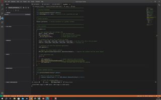

    与配合使用的器件 FR2676_CAPTIVATE BSWP Project using (项目使用) Code Composer Studio 并已成功导入和调试该项目。 但是、我会遇到一个问题、那就是在上未接收到任何信号 P5.2 已通过限流电阻器将其连接到 LED。
    在中 main.c 文件中、我实施了以下代码以将每个引脚的相应引脚设置为高电平
    /* --COPYRIGHT--,BSD
     * Texas Instruments Incorporated, 2017
     * Redistribution and use in source and binary forms are permitted.
     * Full license details are in the header comments.
    // Includes
    #include <msp430.h>                      // Generic MSP430 Device Include
    #include "driverlib.h"                   // MSPWare Driver Library
    #include "captivate.h"                   // CapTIvate Touch Software Library
    #include "CAPT_App.h"                    // CapTIvate Application Code
    #include "CAPT_BSP.h"                    // CapTIvate EVM Board Support Package
    #include "gpio.h"                        // Include GPIO control headers
    // Macros and Definitions
    #define BTN_1       (0)
    #define BTN_2       (1)
    #define BTN_3       (2)
    #define BTN_4       (3)
    #define CLEAR_LEDS  P5OUT &= ~(GPIO_PIN0 | GPIO_PIN1 | GPIO_PIN2 | GPIO_PIN6) // Clear previous states
    // Function Prototypes
    void yourSensorHandler(tSensor* pSensor);
    void setPinHigh(uint8_t pin); // Function to set a specified pin high
    // Global Variables
    tSensor yourSensor;  // Declare yourSensor as a global variable
    // Main Function
    void main(void)
        // Stop watchdog timer and configure MCU
        WDTCTL = WDTPW | WDTHOLD;            // Stop watchdog timer
        BSP_configureMCU();                  // Set up device IO and clocking
        __bis_SR_register(GIE);              // Enable global interrupts
        // Configure P5.0, P5.1, P5.2, and P5.6 as output
        P5DIR |= (GPIO_PIN0 | GPIO_PIN1 | GPIO_PIN2 | GPIO_PIN6); // Set P5.0, P5.1, P5.2, P5.6 as output
        P5OUT &= ~(GPIO_PIN0 | GPIO_PIN1 | GPIO_PIN2 | GPIO_PIN6); // Initially low
        // Initialize and start the CapTIvate application
        CAPT_appStart();
        // Register the sensor handler callback
        MAP_CAPT_registerCallback(&yourSensor, &yourSensorHandler);  // Register the callback with the sensor object
        // Main application loop
        while (1)
            CAPT_appHandler();               // Handle capacitive touch processing
            Demo_checkForValidTouchandProximity();  // Custom application processing
            CAPT_appSleep();                  // Enter low-power mode if no tasks are pending
    // Sensor Callback Function
        // Check if a new touch is detected
        if ((pSensor->bSensorTouch == true) && (pSensor->bSensorPrevTouch == false))
            // Clear all previous states
            CLEAR_LEDS;
            // Set the corresponding pin high based on the dominant button
            switch (CAPT_getDominantButton(pSensor))
                case BTN_1:
                    setPinHigh(GPIO_PIN2); // Set P5.2 high for BTN_1
                    break;
                case BTN_2:
                    setPinHigh(GPIO_PIN1); // Set P5.1 high for BTN_2
                    break;
                case BTN_3:
                    setPinHigh(GPIO_PIN0); // Set P5.0 high for BTN_3
                    break;
                case BTN_4:
                    setPinHigh(GPIO_PIN6); // Set P5.6 high for BTN_4
                    break;
                default:
                    break; // Handle invalid button state
    // Set Pin High Function
        // Set the specified pin high to keep it in the high state
        P5OUT |= pin;    // Set the pin high
    尽管成功调试了项目、但仍然没有看到任何信号 P5.2 . 我还验证了 P5所有引脚上的信号、但其中任何引脚上都没有输出。 有趣的是、我可以看到中正确反映的传感器活动 CapTIvate 设计传感器 .
    您能帮助我确定问题吗? 非常感谢您提供任何指导或建议。
    感谢您的时间和支持。
     Sushant
