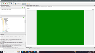

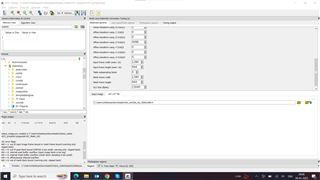

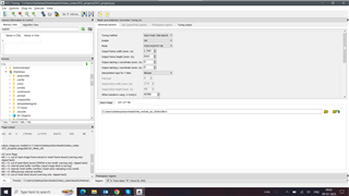

    您能否在 DCC 工具中运行此 LUT 并确认它是否正确且不提供 LDC 错误?
    [报价]
    当运行 LUT 文件共享并将输入映像传递给 DCC 工具时、插件输出如下所示。
    Plugin returned message:
    OBW Factors Checked: 16 32 48 64 80 96 112 128 144 160 176 192 208 224 240
    OBH Factors Checked: 16 32 48 64 80 96 112 128 144 160 176 192 208 224 240
    Best 5:
    OBW OBH pad bandwidth    pix_bw   mesh_bw  pix_max mesh_err
    224  48   0    156224    100608     55616      588      OK
    240  48   0    156224    100608     55616      588      OK
    224  32   0    169792    107136     62656      396      OK
    240  32   0    169792    107136     62656      396      OK
    192  48   0    178048    117376     60672      588      OK
    output_image.yuv created in C:\Users\chaitanya\Downloads\Octave_codes\DCC_projects\.plugoutdir\DC_Mesh_LDC
    LDC error flags:
    bit0 = 1: out of input image frame bound or mesh frame bound (warning only: clipped back)
    bit1 = 0: out of pixel block bound (PIXPAD is too small; warning only: clipped back)
    bit2 = 0: internal pixel buffer overflow (input image block is too big)
    bit3 = 0: internal mesh buffer overflow (mesh down sampling is too small)
    bit4 = 0: affine/pwarp internal overflow
    bit5 = 0: out of mesh block bound (warning only: clipped back)
