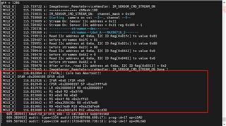

我们在系统启动时遇到随机 DSS 初始化崩溃(TI EVM TDA4H-J784器件):
[MCU2_0] 23.005084 s: DSS: Init ... !!!
[MCU2_0] 23.006342 s: [FATAL]: Core has Aborted!!!
[MCU2_0] DFAR =0x5050408 DFSR =0x808
[MCU2_0] 23.006381 s: IFAR =0x0 IFSR =0x0
[MCU2_0] 23.006401 s: CPSR =0x200f0197 SP =0xa3ffffe0
[MCU2_0] 23.006422 s: LR =0x200f003f R0 =0x200f003f
[MCU2_0] 23.006442 s: R1 =0x20 R2 =0x5050408
[MCU2_0] 23.006460 s: R3 =0x2a800000 R4 =0x4f40010
[MCU2_0] 23.006479 s: R5 =0x10001 R6 =0xa3885173
[MCU2_0] 23.006497 s: R7 =0xa39e7b68 R8 =0xa35e87a8
[MCU2_0] 23.006518 s: R9 =0xa35d2240 R10 =0x2
[MCU2_0] 23.006536 s: R11 =0xa39e7bbc R12 =0x277
即消息"dss: init…done!!" 缺少。
附加到此消息后、您将找到完整的日志文件- dss_dss_log.log Init_Crash。
感谢您的观看!

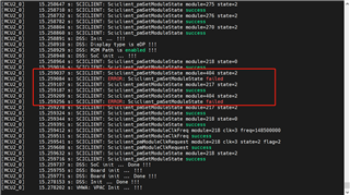

    尊敬的 Dmitar:
    但在失败的情况下、我看到 SciClient API 失败、您是否确定 mcu1_0运行正常并且没有崩溃。
    [MCU2_0] 23.116772 s:SCICLIENT:Sciclient_pmSetModuleState 模块=218 STATE=0
    [MCU2_0] 23.116826 s:SCICLIENT:Sciclient_pmSetModuleState 成功
    [MCU2_0] 23.116847 s:SCICLIENT:Sciclient_pmSetModuleState Module=404 state=2
    [MCU2_0] 23.116893 s:SCICLIENT:错误:Sciclient_pmSetModuleState 失败
    [MCU2_0] 23.116916 s:SCICLIENT:Sciclient_pmSetModuleState 模块=217 state=2
    [MCU2_0] 23.116960 s:SCICLIENT:错误:Sciclient_pmSetModuleState 失败
    [MCU2_0] 23.116983 s:SCICLIENT:Sciclient_pmSetModuleState Module=404 state=2
    [MCU2_0] 23.117027 s:SCICLIENT:错误:Sciclient_pmSetModuleState 失败
    [MCU2_0] 23.117049 s:SCICLIENT:Sciclient_pmSetModuleState Module=217 state=2
    [MCU2_0] 23.117093 s:SCICLIENT:错误:Sciclient_pmSetModuleState 失败
    [MCU2_0] 23.117114 s:SCICLIENT:Sciclient_pmSetModuleState Module=218 STATE=0
    [MCU2_0] 23.117159 s:SCICLIENT:Sciclient_pmSetModuleState Success
    [MCU2_0] 23.117180 s:SCICLIENT:Sciclient_pmSetModuleClkFreq 模块=218 clk=3 freq=148500000
    [MCU2_0] 23.117271 s:SCICLIENT:Sciclient_pmSetModuleClkFreq 成功
    [MCU2_0] 23.117294 s:SCICLIENT:Sciclient_pmModuleClkRequest 模块=218 clk=3 state=2 flag=2
    [MCU2_0] 23.117357 s:SCICLIENT:Sciclient_pmModuleClkRequest 成功
    [MCU2_0] 23.117379 s:SCICLIENT:Sciclient_pmSetModuleState Module=218 STATE=2
    [MCU2_0] 23.117472 s:SCICLIENT:Sciclient_pmSetModuleState Success

    您好、Brijesh、
    对于上述所有三种情况、此 SciClient API 始终失败:
    当  模块217的 SciClient API 出现故障、但并非总是   出现故障、且没有致命崩溃时、显示屏上没有信号:
    如何检查 mcu1_0是否运行正常且不崩溃、 以及与 DSS (其初始化在 MCU2_0上)的连接是什么?
